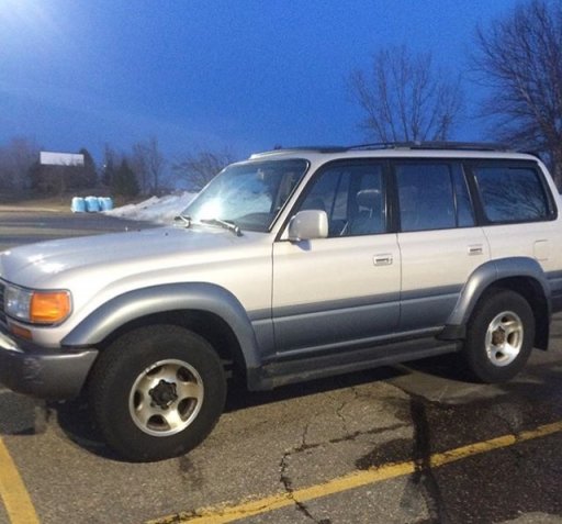

This story begins in February, after a two year search, when I scored my favorite color 1997 LandCruiser with lockers with 222,000 miles for 2500 dollars. I had set up an email alert on Craigslist, so I messaged the guy about 5 minutes after the ad appeared. By the time he had responded to me 20 minutes later, he told me I was one of four potential buyers, but he told me I was the first. I drove up that night and bought the Cruiser for the 2500 dollar asking price. 20 minutes into the ride home, it overheated, so I pulled over and realized my coolant had leaked out. I added coolant from the as station and drove it home. Here it is the night I drove it home.

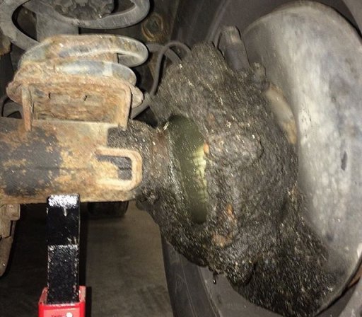

I then decided to address the steering knuckles, which were long overdure for a rebuild.
When the rebuild kit from cruiser outfitters arrived, I got to work on the front axle.
After completing both sides, I sent my wheels in to be blasted and powdercoated.
