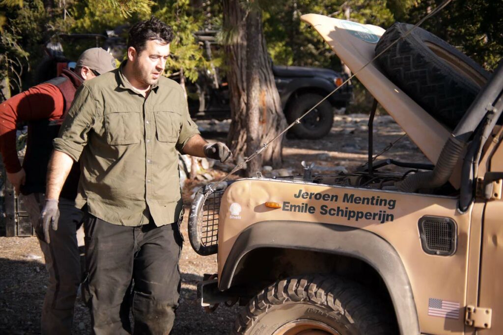

Hahahaha….EVERY…..DAMN…..TRIP! Not always major things but always something. Take your pick of repairs: the time I lost a trailing arm bolt and used a trailer hitch pin or the time my dampener took out the sway bar drop arm nut which allowed the drop arm to swing free and break the line between the auxiliary tank and the main tank so I was dumping diesel from both tanks in the middle of Death Valley or… well you get the point. The list goes on and on. I am prepared for most issues when it comes to repairs.

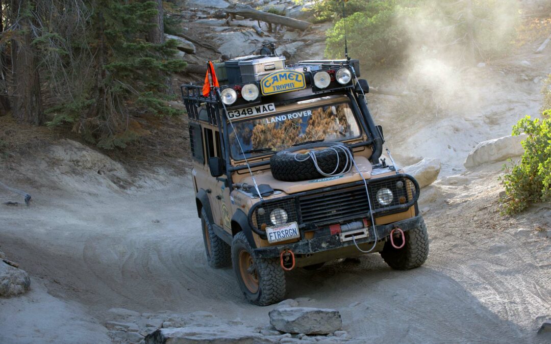

Engine swap to a 200Tdi Land Rover engine
Transmission upgrade
Rear axle swap to Salisbury (what was originally on the truck)

Suspension:
2 inch lift, Old Man Emu dampeners and springs
Tires:
BF Goodrich KM3s 275/75/16
Wheels:
Land Rover “1 Tonne”
Recovery:
Dixon Bate recovery points front x2, rear x1
ARB snatch strap
Factor 55 closed winching system soft shackles, van Beast D rings
ARB tree strap
Superwinch Husky 10 worm drive winch w synthetic line
My brain 😂
Security:
Manual transmission
Nav/Comm:
Gaia GPS on ipad
Yaesu 8800 HAM radio
Baofeung HT radios
CB
Mechanical/Engine:
2.5L Land Rover 200Tdi
