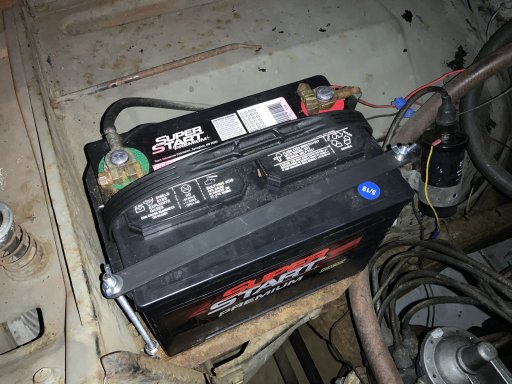

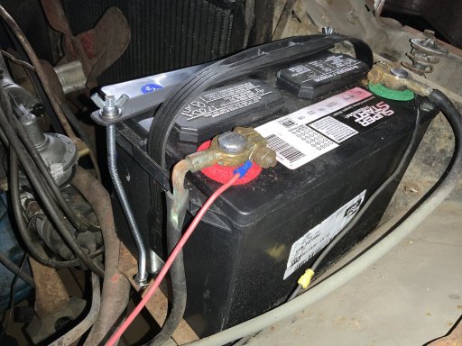

Took it (the new one) to get the old one licensed and title transferred. Stopped by Home Depot on the way home to pick up some steel, all thread, nuts and washers to fabricate a battery tie down for the old one.

Got the alternator in the J200 last night and it is now charging the battery. Today, make something to hold the battery in place and a gear oil refill party! Then a drive with the boy.
I broke the first alternator last night, snapped the ear off while (over) tightening. It had a helix in it which tells me there was some damage there in a previous life. Luckily OReillys had another on the shelf and they graciously warrantied for me. I told them what happened and they were awesome.

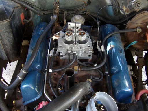

More or less finished installing a Howell TBI kit on a 76 Jeep Cherokee. Fired right up with no fault codes! Runs pretty well, but I do have an exhaust leak to tend to and a little electrical clean up on the passenger wheel well. The 6-12 hour advisement for install was a little off. It took 2 months pecking away at it here and there on weekends and working on mounting solutions.....
1. Custom computer mount behind passenger side dash.
2. Custom fuel pump and filter mount along frame rail.
3. Hard lines for fuel supply and return over engine.
4. Complete undo and redo of wiring harness to actually match vehicle an engine layout.
5. Cut and reweld of throttle cable bracket to get full throttle movement.
6. Fabbed a MAP senor mount out of a spring clip.
7. And so on. Ran the harness along exisitng harness runs. Once dirty, it will be hard to tell it is not factory.
The air cleaner could be replaced with an open element and still be smog legal, but I left the original with the hot air system for warm up. This is my hunting rig and does see high elevation and below freezing temps. Easy enough to keep the stock stuff and avoid any icing problems.
