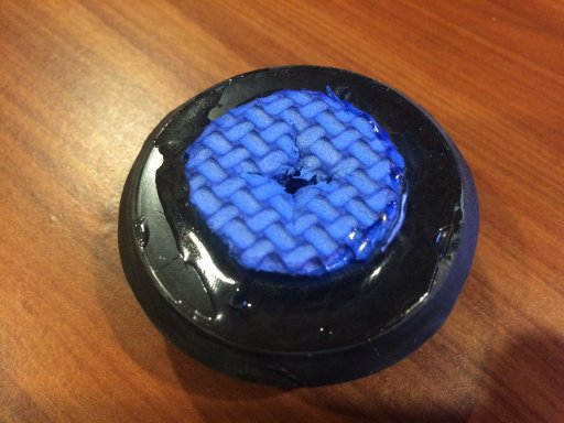

Got my antenna installed yesterday and the antenna cable and power cables are ready to route through the firewall. Drilled out the middle of the plastic plug in the empty "clutch hole" in the Gladiator firewall and epoxied in some yoga matt (camping shower floor) to provide some weather proofing. Epoxy is dry this morning and I hope to get the radio fired up later in the day.

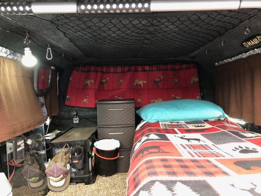

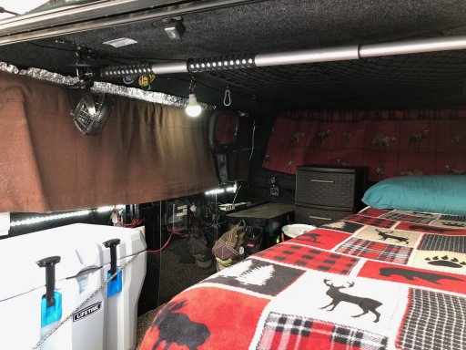

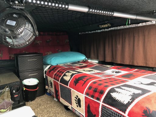

Looks awesome! Whats the rear facing camera by the dresser for? Have one of those LED USB bulbs and it has been awesome over the years!
It is a security camera. If it senses motion or loud noise, it will start recording. It can also be activated with a remote control. There is also a second attached camera above the camper shell entrance window. It's the little black box looking thingy.
So in case any two-legged creature decides to mess with me or my rig, I'll have it recorded. Of course if that main camera is taken, then I'm SOL lol.

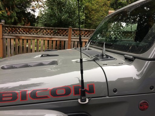

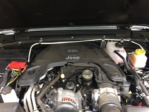

The under the hood part of the radio install is done; wires now in the cabin and need to be routed under the trim to the back seat. Project part next... ;)
Antenna mount. Seems pretty robust/stable so I have not installed the extra self tapping screw.
Power routed from battery to firewall hole
New wires going into super plug
This part is done.

Nice clean install. I have my CB antenna mounted in the similar location and have excellent SWR readings.

What about tree limbs and such. Will they be a hindrance to that location ? I have no idea where a good location is for permanent mount. I think my Midland radio comes with a magnetic roof mount (havent installed it yet) . If I get into the tree branches I just bring it inside I think. Still house bound so won't know anything until I can hit the trail in November I hope.
Thanks! Got the wires hidden under trim and ran to the radio. Got an APRS packet out (and received some) with a cheapo mag mount antenna! Woot! Now just need to solder the PL-259 end on the new antenna cable and wait for the display and mic extension cables. Then clean up all the cable madness... Will be good to have my trusty radio back! Running out of cheap upgrades :)

I got the springy extra attachment for this antenna to help for when I pull into the garage and under tree limbs. It also folds down easily - the only challenge is me remembering to fold it down BEFORE hitting something :)

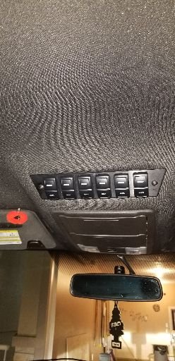

Added some upfitter switches to my f150. They aren't wired up to anything but I just got them run into the engine bay for now in preparation. Next project will be a relay & fuse panel.
Looks good, good location, how did you do that. How will you get wires too and from the switches is a better question ? Is your upholstery removable ? Duaaaaaaaaaa :-/
