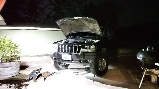

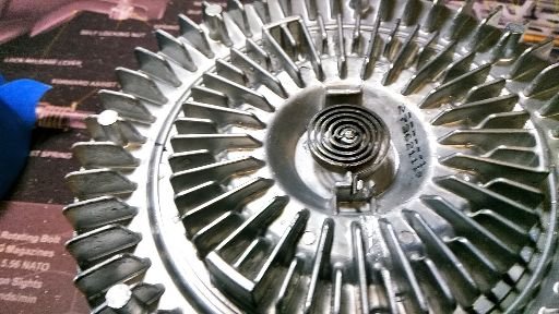

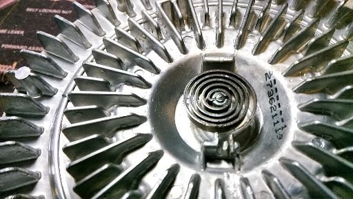

Replace faulty clutch fan. (Hayden is on my Crap list, might have cost me a motor). Modified it for a second spring position- a heavy duty position for times like triple digit temps when pulling a trailer up Steens Mountain at max gross vehicle weight. Did not like 245 degrees last week on the old 4.7. Also replace JKS track bar bushings. They should have not gone south so quick, found the welding bead on one side interfering with the bushing seating fully. That explains it. A little angle grinder time and good to go. I'd have thought better of JKS. Oh well, my battle with crap manufacturing and faulty parts continues. Also added alumaseal to the 6 month old radiator. When cold one of the tank seams leaks. Time to order my 3rd radiator.......

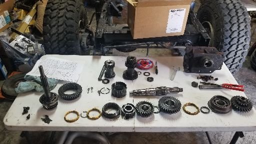

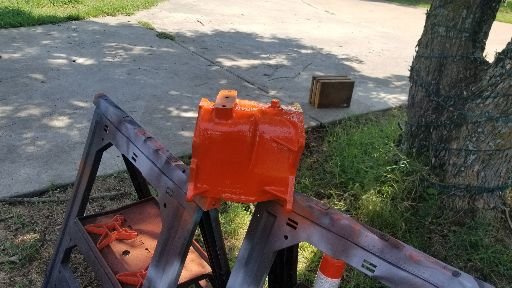

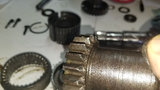

Tore down the CJ transmission down yesterday. Inspected and figured I need to order a few more hardparts that dont come with the rebuild kit and got the housing cleaned and painted.

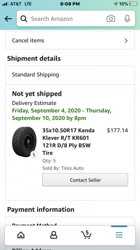

I’ve heard nothing but good so far and at that price I’ll take a chance. Be nice to run 35s with only 2” of lift
You couldn't do that to my LRD2 without cutting the wheel wells out. I would need 4" of lift for a 35" tire. I'll stay with my 2" lift and 32" tires.
