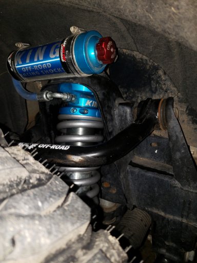

I tried to swap out the King 550lb springs on my coilovers to 450lb springs. I then realized the typical strut spring compressor won't fit between the coils of my springs. So after playing with bailing wire and ratchet straps for awhile I decided I'm too young to die so I took them to a local 4x4 shop and they swapped them for me for $65. Thanks WFO Concepts.
I reinstalled the coilovers with about 4 threads showing but after a test drive I found the front end was still sitting at 39"+ with the driver side at almost 40"! I had removed all the weight I had bolted to my skid plate (100lbs+-) but it's now sitting slightly higher than the 550lb springs and extra weight. :unsure: It drove great, however! After checking droop, which is same as before, I decided to reduce preload as far as I can and I'll test it out tomorrow. My goal is to increase droop (down travel) and increase ride quality.
I'm stoked to still get the height I want from this relatively low spring rate and the ride is even better than before. The non-stoke part is I went with cheap springs and they are plain silver instead of King blue. lol

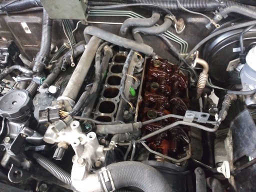

After playing around making that discada/skottle i decided it was finally time to fix the driver's side oil leak and install new plugs and wires.
Looks like a nightmare to me. I hate modern engines and how complicated they have made everything. You dun good man !

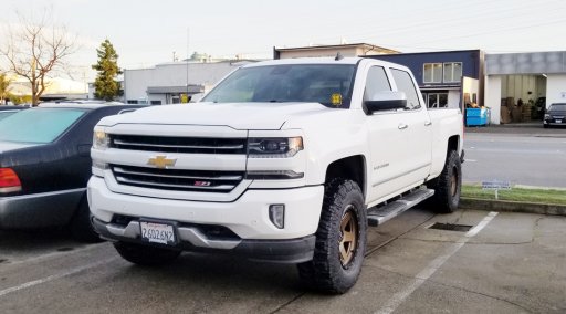

View attachment 134478Step one toward a mild vehicle for use in high desert canyons and off system roads. Leveler plus Grenade rims and Nitto Ridge tires.
I'd scrap the spoiler and running boards fast. Otherwise I like your truck from what I can see.
You might get lucky and the springs settle to where you want. When I did the coil over on the Tahoe the front settled about an inch in the first week. After adjusting, the springs have held steady height for 2+ years so far. When adjusting go by frame height side by side. Fender height can be inconsistent side to side in general.
