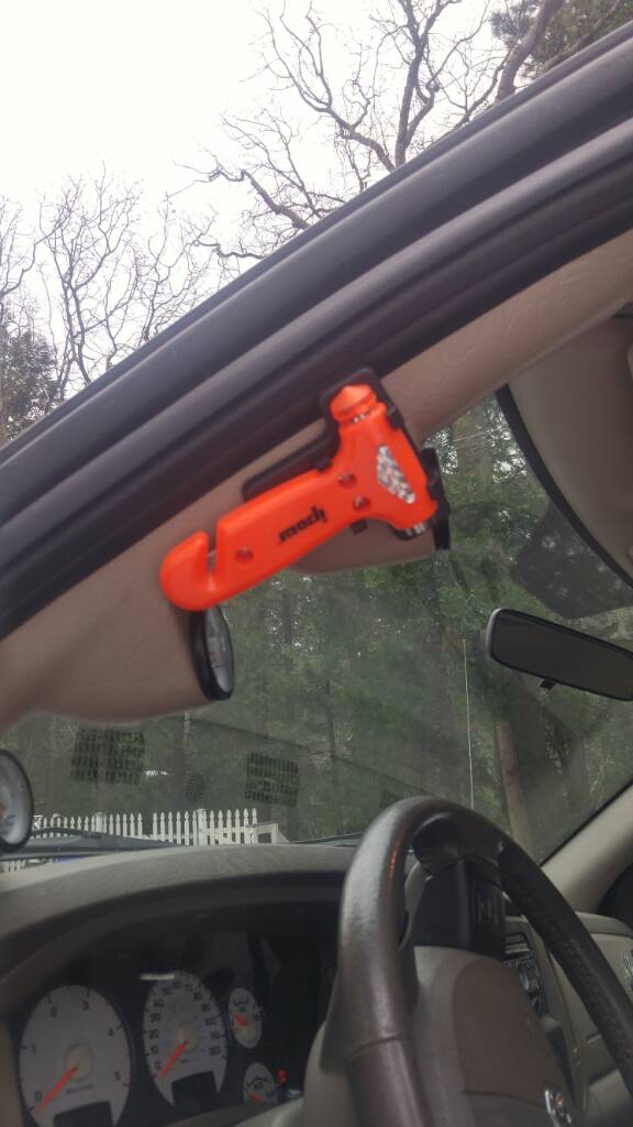

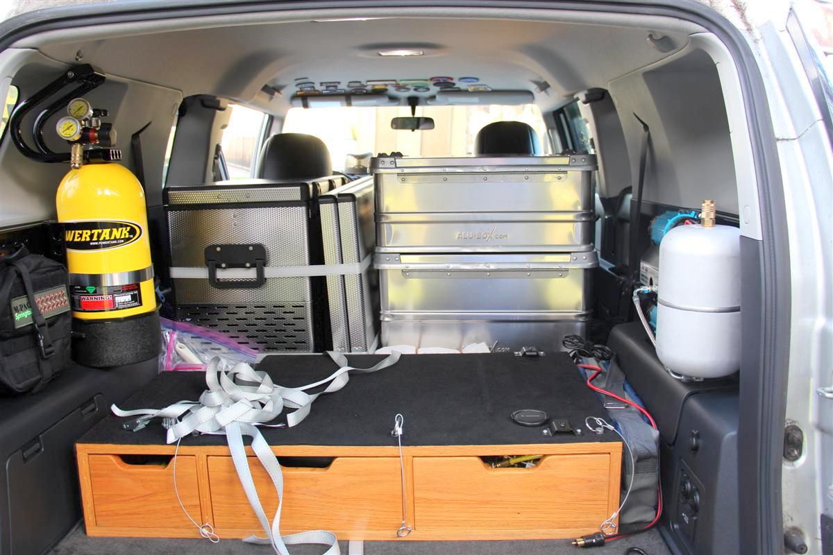

Emergency glass breaking hammer/seat belt cutter..

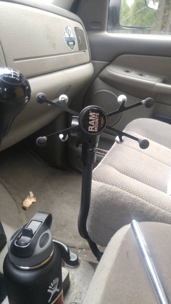

Ram mount tablet mount.. Now to buy a dedicated tablet for navigation.

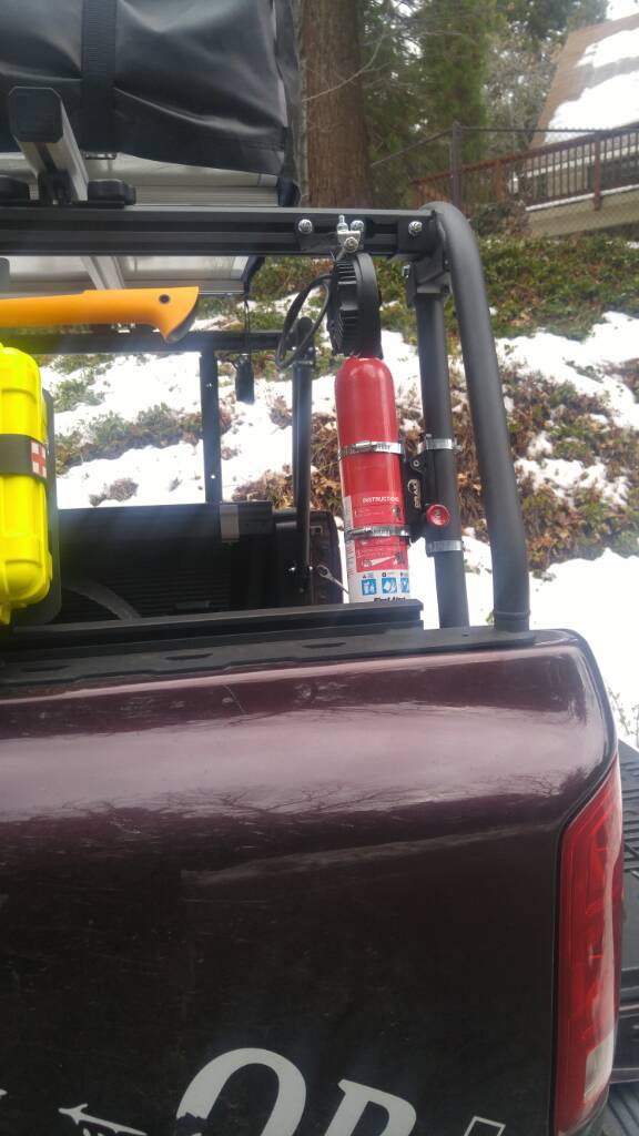

Drake quick release fire extinguisher mount:

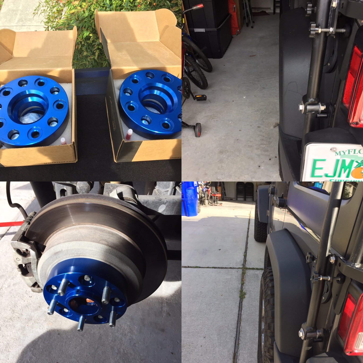

CB Radio Install:
I settled on the Midland 75-822 b/c it is easily removed from the Jeep and I won't have a radio taking up space. The antenna mounts to the Hi-Lift jack mount, then the coax is run through a small hole in the bottom of the taillight up into the cab through a grommet, and under the carpet to the passenger seat. I brought it out by the center console so it is discreet when the radio isn't plugged in.
View attachment 12685 View attachment 12687
ARB Fridge Wiring Kit:
While I had the passenger side carpet and trim panels pulled, I ran the wire for the ARB fridge. I buy my pants in the husky kids section (you 70's & 80's kids know what I mean), so the fridge is going on the passenger side of the cargo area to balance the load a bit. It's pretty straight forward: wire to the battery, mount the socket in a convenient space in the rear.
Bussmann Relay/Fuse Panel Install:
This is a DIY SPOD that I picked up off a fellow from a Jeep specific forum. It's universal in it's application, but you may have to fab up your own mounting brackets. Basically you have a 80a circuit breaker, the relay/fuse panel that has 5 relay/fuse circuits and 5 fuse only circuits, and a switch leg for the relay circuits. It took the longest to install this, but that was because I was tucking the wires and making it all super clean. This is the foundation for adding electrical accessories in the future and keeps the engine bay from becoming a rat's nest of wires.
View attachment 12688 View attachment 12690

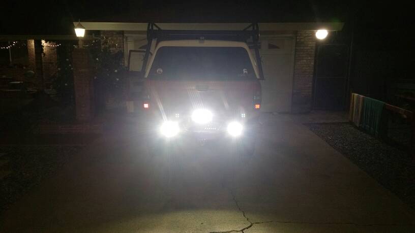

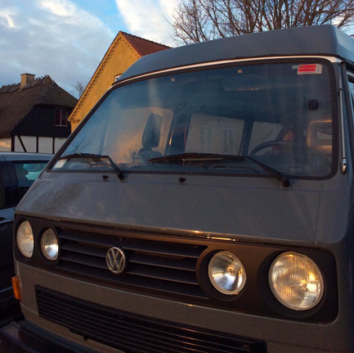

New set of eyes on our VW SYNCRO today...and thinking of adding a set of IPF 968....any experience with those anyone?

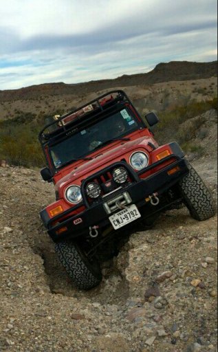

Yup, I have a set of them on my Jeep. I like them for the price with the 55W bulbs but they do come with 100W bulbs. I've just been too lazy to put them in. They aren't super bright but that's again because I don't have the 100W bulbs in. They have done their job the last two years for. Because I have the 55W bulbs in (I really just assume), I am able to normally run these and my low beams while driving for added visibility which is a nice convenience when on farm roads in Texas
Mounted on the Jeep. They will be relocated soon to the rack in favor of a pair of LightForce 240s HIDs on the front bumper

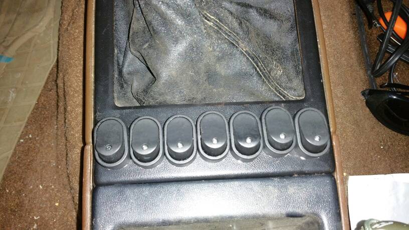

Rewired my electrical switches and added 3 more for the next upgrade.
