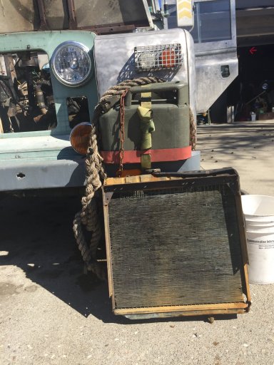

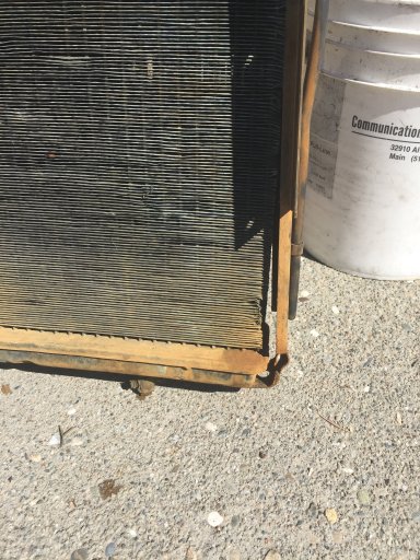

In my efforts to be a good Overlander and Land Rover owner I go out to do the preventive maintenance on Oliver. I pop the bonnet and do a visual inspection and start checking fluids. At this point I discover that the coolant is down fairly low. I top it off and then start it up and fiddle with the trimming a bit as it seems to be slightly off. I finish that, then walk to the front of Oliver and notice that I'm standing in a puddle... The good news, I found out why my coolant was low. The bad news, I have to fetch out the radiator and see about getting it repaired.
Ah the joys of owning an older car.

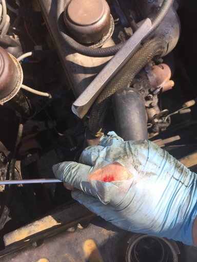

Well here it is. The job wasn't too bad. I did reaffirm a few things about turning wrenches: 1) the bolt or screw that is stuck will be in the hardest to reach spot. 2) in order to remove the broken part you need to remove at least 5 good parts. 3) I am still a proud member of the Bloody Knuckles Brotherhood.
