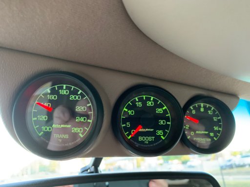

So, since we last spoke, Creedence received:
A new gauge pod, and...

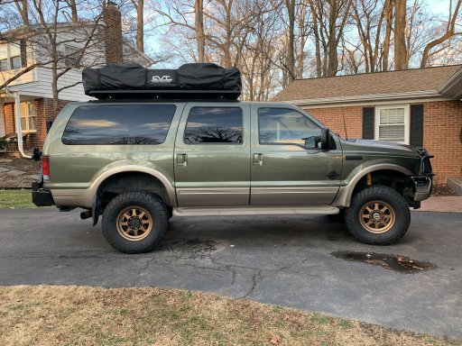

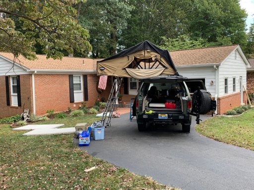

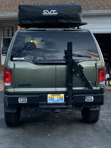

and a Rhino Rack Pioneer Platform for our...
CVT Mount Denali RTT ahead of our first "real" trip with the rig. Possible review to follow, if there's interest.

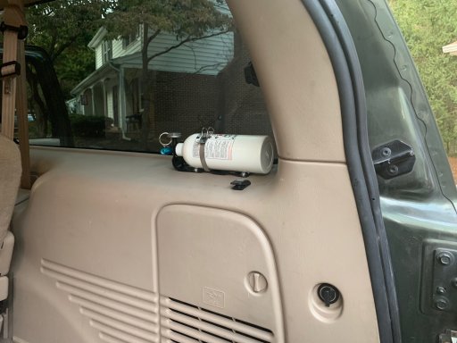

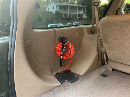

Additionally, I added some dedicated fire extinguishers (one up front, one in the rear) and a cheap-and-easy place to mount the air line:
The missus, my youngest son, the dog and I headed out earlier this fall with the intention of driving the North Carolina section of the Trans-America Trail, but we got a late start/sidetracked and ended up pivoting with more of a lengthy road trip and exploration in some few national forests in western Virginia, North Carolina, Kentucky, and Tennessee. Didn't do a very good job of taking pictures, but here's one of the rig (and dog) at a creekside campsite in the Cherokee National Forest:
Quick shot of the RTT mostly deployed (WAAAY up in the air!) to dry out during our not-so-fun post-trip cleanup:

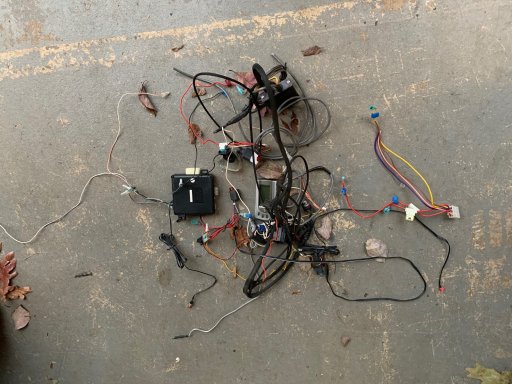

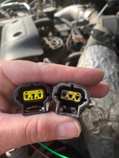

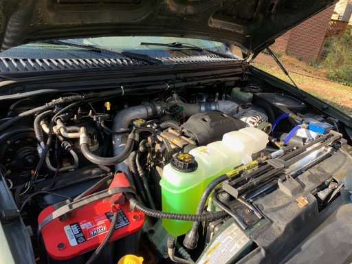

Since then, mostly maintenance on the rig, including replacing a few electrical shorts:
Finally getting around to cleaning the dirt out from the engine bay...look at that puddle! Also installed a new degas bottle and a coolant filtration kit.
And removing a TON of hack-job wiring, an old tuner, and a remote start installed by a previous owner...some wiring was done with scotch tape!

That pile of wiring is scary. You've come a long way. I doubt your transmission is in any danger from larger tires. Your diff gearing may suffer from the high gear ratio you currently have. You have a full size rig so everything is pretty beefy if your not a wild man. New gears are very costly and you wont know for sure if you will need them until you try. You have a low range transfer case and that will handle the slow driving part. Just don't go bonzi on the tire size and it will probably be okay with modestly large tires. this is my opinion for what it's worth.

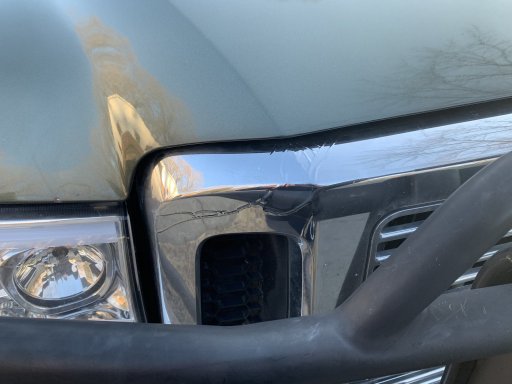

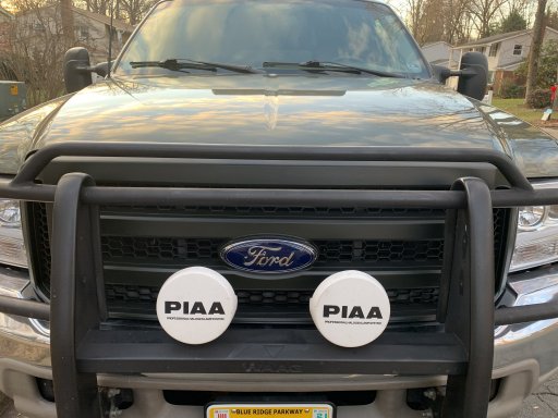

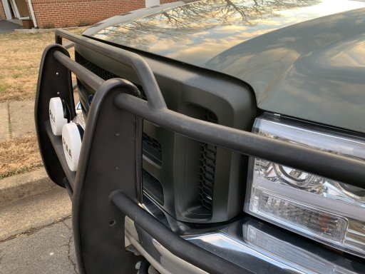

In my goal of de-chroming Creedence, I replaced the "chrome" (read: chrome-wrapped that was peeling) updated grille for a matte black one.

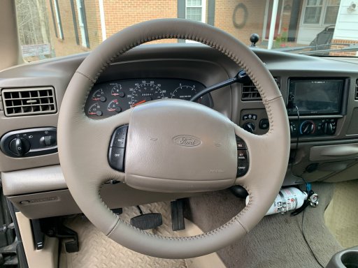

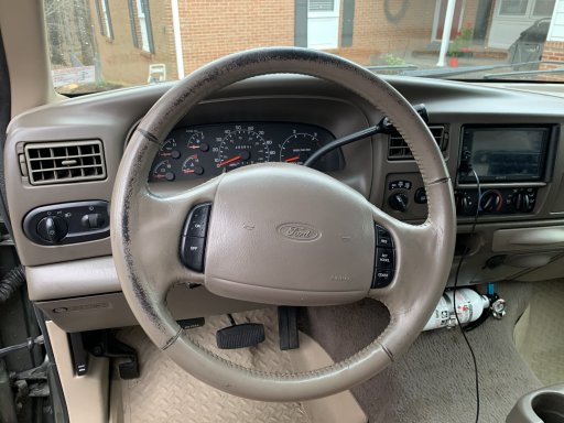

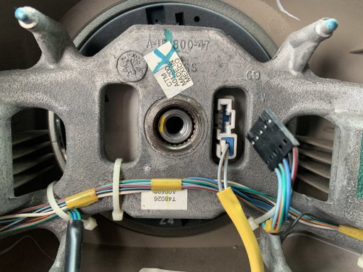

Then, it was time to replace the old steering wheel. It turned the vehicle just fine, of course, but the "leather" was 20 years old, had lost most of its padding and was loose on the wheel, and was just plain unsightly.
Unfortunately, nobody really makes "new" wheels for the previous Super Duties and Excursions, so I was left with a wheel cover (unsightly), trying to find a better-quality used wheel, or...I happened to stumble on a guy on Ebay (search "Autowoods") who recovers wheels. For about the price of a used wheel, and less than I was quoted for a hand-stitched partial cover, I got a recovered wheel that is pretty darn close to the original leather. Solid. Can't recommend enough. Also learned how to properly de-charge an airbag and use a puller to remove the original wheel.

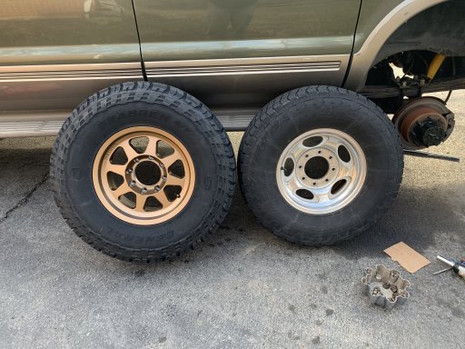

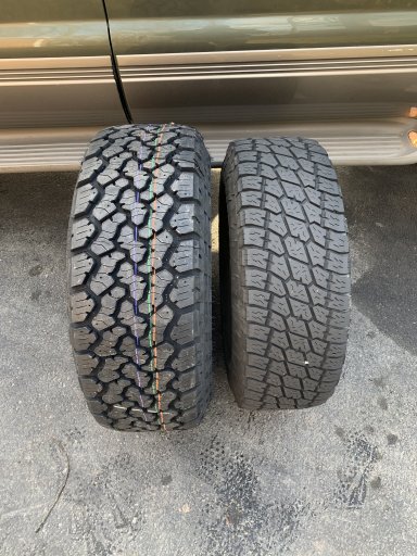

Lastly...since the lift was done last August, Creedence looked like he kept skipping leg days. The 285/75R16 tires, while +1 from stock and capable enough (got me up Bald Mountain Jeep Trail without any problems) aren't quite as wide as I'd like, and made the truck bog a bit because the gears were stock 3.73s. So...an installation of Yukon 4.11s front and rear, an Eaton True-Trac (decided against the air locker...I wanted something that was functioning all the time), new bearings, seals and axle universal joints a few weeks ago set us up well for the delivery of 35x12.5 General Grappler AT/Xs on 17x8.5 Method 701s. They fit, but I had to lose my front mud flaps, air dam, and I may have to trim the bumper a bit until I can get my aftermarket one in (looking at Buckstop Truckware).
But. They. Look. Awesome.
