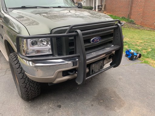

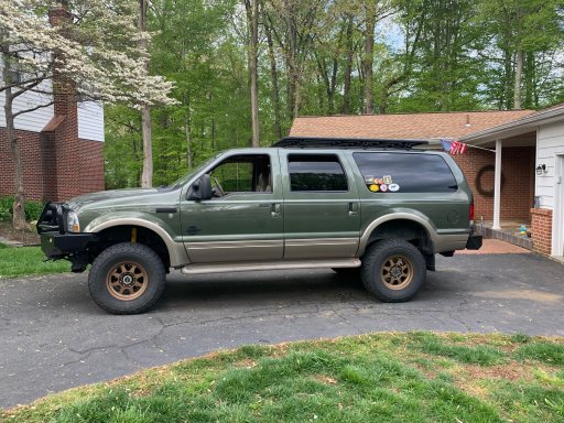

In my goal of de-chroming Creedence, I replaced the "chrome" (read: chrome-wrapped that was peeling) updated grille for a matte black one.
View attachment 139039View attachment 139040
Then, it was time to replace the old steering wheel. It turned the vehicle just fine, of course, but the "leather" was 20 years old, had lost most of its padding and was loose on the wheel, and was just plain unsightly.
Unfortunately, nobody really makes "new" wheels for the previous Super Duties and Excursions, so I was left with a wheel cover (unsightly), trying to find a better-quality used wheel, or...I happened to stumble on a guy on Ebay (search "Autowoods") who recovers wheels. For about the price of a used wheel, and less than I was quoted for a hand-stitched partial cover, I got a recovered wheel that is pretty darn close to the original leather. Solid. Can't recommend enough. Also learned how to properly de-charge an airbag and use a puller to remove the original wheel.

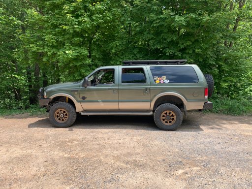

Lastly...since the lift was done last August, Creedence looked like he kept skipping leg days. The 285/75R16 tires, while +1 from stock and capable enough (got me up Bald Mountain Jeep Trail without any problems) aren't quite as wide as I'd like, and made the truck bog a bit because the gears were stock 3.73s. So...an installation of Yukon 4.11s front and rear, an Eaton True-Trac (decided against the air locker...I wanted something that was functioning all the time), new bearings, seals and axle universal joints a few weeks ago set us up well for the delivery of 35x12.5 General Grappler AT/Xs on 17x8.5 Method 701s. They fit, but I had to lose my front mud flaps, air dam, and I may have to trim the bumper a bit until I can get my aftermarket one in (looking at Buckstop Truckware).
But. They. Look. Awesome.
View attachment 139047View attachment 139048View attachment 139050View attachment 139051

The 35's look kinda small on that Excursion with that lift, not complaining, just saying what I think.

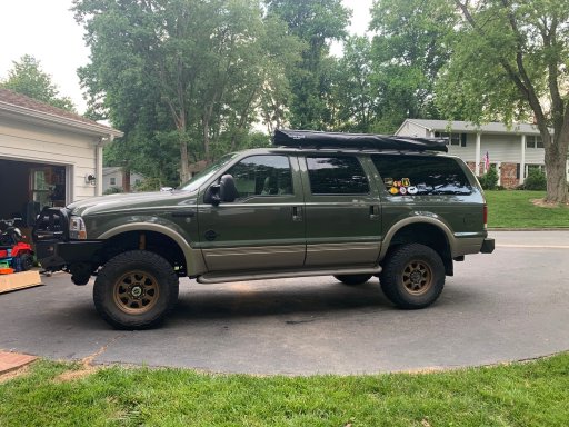

Went with 35s for a number of reasons. Firstly, the front leafs REALLY complicate larger tires. You can squeeze them in, but anything beyond 35x12.5 will rub on the springs and wheel well liner. That, and there was no way I'd be able to keep my stock bumper...I barely fit the 35s in and even then I had to do surgery on the front end. Secondarily, there's the extra cost of tires. Thirdly, my kids have a hard enough time getting in the truck...adding another inch would only increase the whining and complaining! :grin:

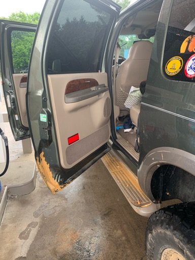

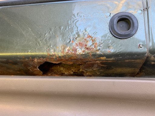

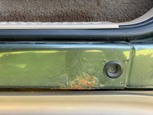

Regarding rust: I hoped to avoid it, but just found some rot in one of the rocker panels...sigh.

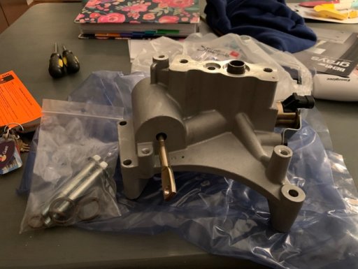

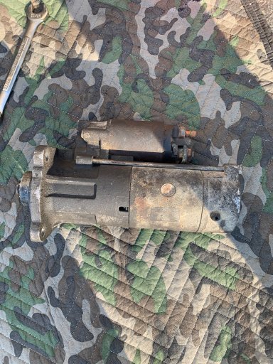

Upgrades/maintenance: Creedence started going through some oil, so new injectors made its way into the rig (you can see from the picture that the o-rings had shrunk, allowing the oil to sneak by), along with the remaining six glow plugs, under-valve cover wiring harnesses, and a new turbo pedestal (o-rings there also brittle). Oof.

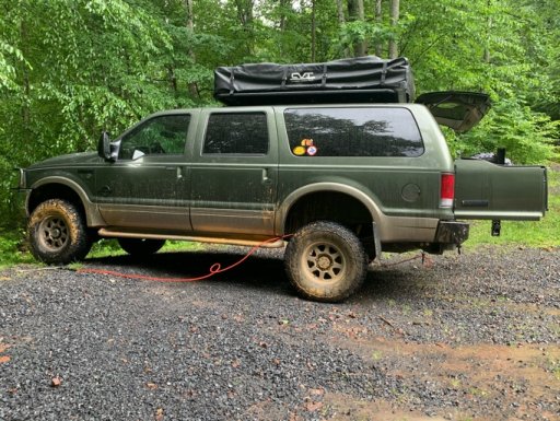

Nothing terribly exciting trip-wise...did Tasker’s Gap in the George Washington National Forest a week or so ago. Rainy/muddy, but it’s an easy trail.

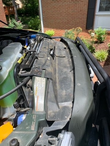

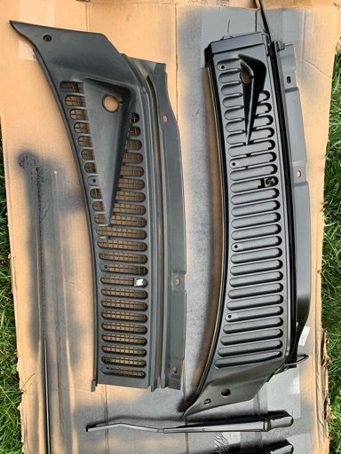

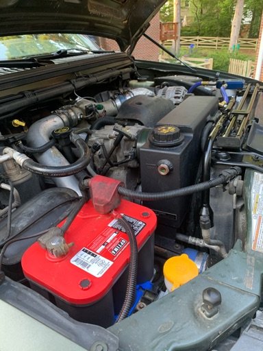

So...some prettying-up of the truck happened, and what should’ve been an easy fix led to wound to my pride (that could have been A LOT worse).
Given that the truck is 20 years old, some fading of trim is expected. I got tired of seeing the dingy, ash-colored trim and faded windshield wipers, and so I decided to do something about it. A can of Rustoleum semi-gloss and an hour or so of work, and voila. While I was there, I also installed a factory replacement for the rubber mat that covers the access to the radiator, charge air cooler and transmission cooler. Prettier up the mud flaps with some matte paint I had lying around, too.

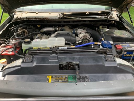

Now for the repair...Ford 7.3s have a degas bottle on top of the radiator that serves as a (pressurized) overflow for the radiator. They have a tendency to fail (and get really ugly), which is why I replaced mine about six months ago. I noticed in recent days a slowly-gaping pool of coolant under the truck after long drives...turns out that the sonic weld that connects the two pieces had a small leak. I expected better from Motorcraft, but decided that I didn’t want to take the risk. I ordered up a Mishimoto coolant tank and installed...pretty straightforward.
What you might notice in the final picture is a new Optima Red Top battery. The trucks primary battery tray was getting a bit rusty, so while I was painting everything else I figured I’d clean it and give it the Rustoleum treatment as well. I reinstalled the tray and battery and went to hook it up—what I didn’t pay enough attention to was how the battery had to be mounted backwards (when looking at the label) because the cables are reversed on the passenger side. So, guess what happens when you hook up an 800 CCA battery backwards? It melts down, you get a bunch of smoke under the hood...not good. Fortunately, no fire.
Humbled, I had to do quite a bit of running around to find a replacement on the evening of July 3rd (because everyone was closing for the holiday). Reinstalled the battery (properly), gingerly started the truck...everything seems fine.
Lesson learned!

During the past 9-ish months, work has continued on the Ex. Sadly, the adventures haven't because of...life in quarantine...but let's see if we can change that.

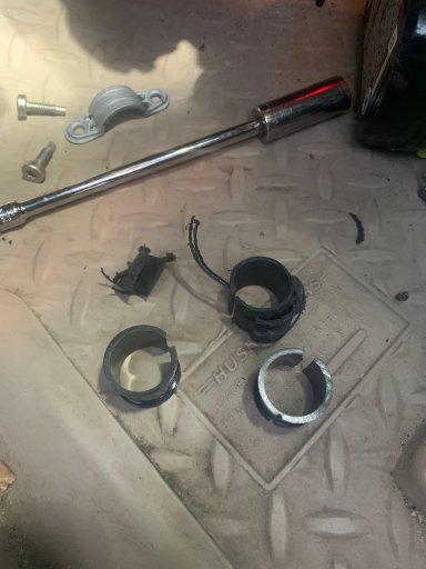

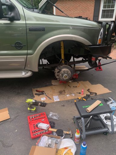

-- In November, I had to have the front leaf springs dropped because the rubber bushings that came with the ARB springs didn't hold up (and I was NOT driving the rig hard). So I had some Energy Suspension poly bushings added to both fronts...let's hope they hold for a while!

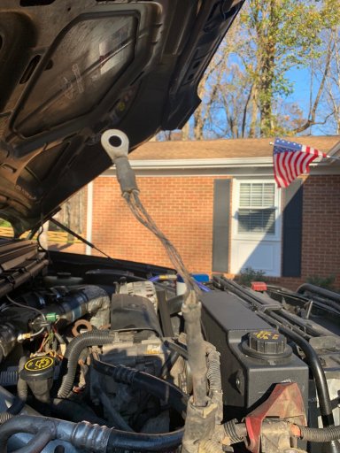

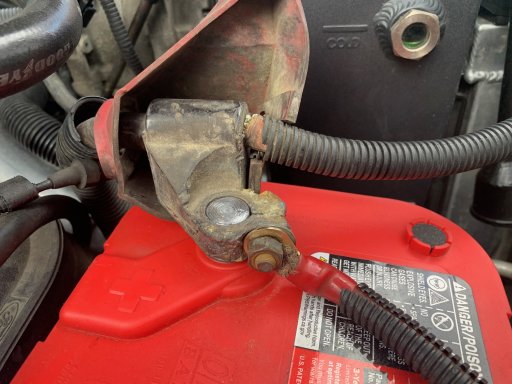

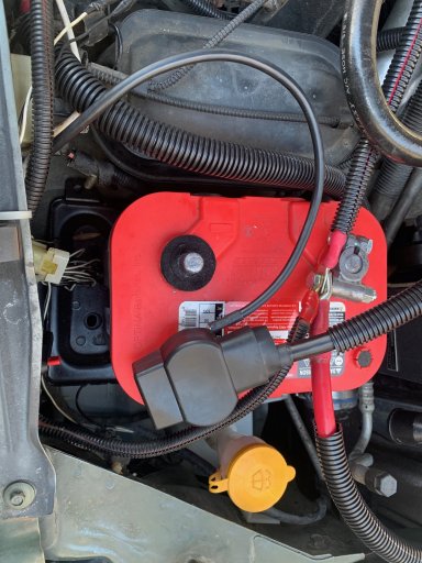

-- Later that month, I figured it was time to deal with the stock battery cables. As you can see from the picture, they were in SAD shape. Unfortunately, stock 7.3 cables are nigh-on impossible to find, so I called Custom Battery Cables for one of their sets--which are larger-gauge than stock. Of course, the auxiliary connection running to the original starter gave up the ghost, so...the rig got a new Motorcraft starter as well. She starts a bit better, but old 7.3s tend to be a bit grumpy with the starting no matter the weather...more on that later.

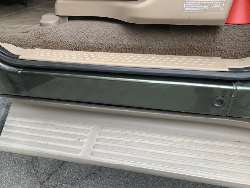

-- At the end of December, I decided it was time to take care of some rust in the left rear rocker that was getting bad. I think this truck was taken out on the beach a fair bit, which probably made all Excursion's penchant for rust there and in the rear door doglegs even worse. Repair looks great...I'm hoping we stopped the cancer, but we'll see...
-- The late-winter/spring didn't see much activity as I saved parts and money for a big upgrade (aside from replacing some bushings to correct the loose/grindy shifter), which finally wrapped up in April: I got rid of the old, rusty brush guard in favor of an ARB bumper that I picked up from a fellow OB member in January. The bumper is filled by a Smittybuilt 15.5k winch, KC Pro Sport spots, and a F55 flatlink. It TOTALLY changes the look of the rig, and finally replaced the last bit of chrome. I can definitely feel the increased weight, but the protection outweighs the downside.

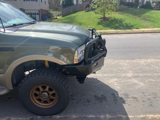

I've decided to keep the rig...and double down a bit. Ultimately, it came down to the fact that even the base-model Power Wagons I was looking at were right at MSRP (with very little flexibility shown by many dealers)...meaning anywhere from 55k-65k. So I can either spend some more on the Excursion and get a cool rig that is outfitted the way I want it to be, or spend a LOT more for a stock pickup truck. This means that I'm planning on a complete engine teardown/rebuild, a transmission refresh, some underbody rust prevention, and recovering/restoring the two front seats. I already have a carpet kit, so that'll go in at some point as well. Lastly, I like the idea of a RTT, but I'll definitely go with a smaller, lighter one...perhaps an Ikamper or a Roofnest that's a bit more aerodynamic!

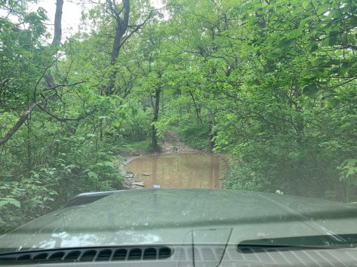

Took a trip to Flagpole Knob yesterday as a recon mission before bringing the missus, who hates bumpy rides. Unfortunately, even with airing down to 30 pounds per tire (from a normal 55-60), the leaf spring suspension on Creedence still leaves a lot of jounce/sway. I got to play with the winch a bit to pull a downed tree out of the path (note to self: pack a folding saw) and only had to go into 4WD three times, but the path was definitely tight and added some pinstriping in addition to a number of small/fun "water crossings" (muddy puddles). Good day with my 3-yo travelling partner, who helped me find a number of cool camping sites for the future.

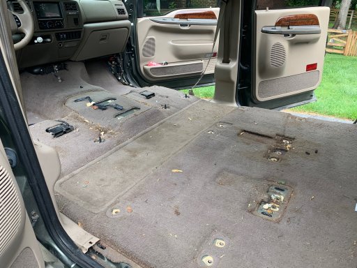

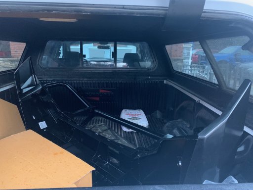

No new trips, but some much-needed interior upgrades. Why interior? Because this beast is my daily, and the ol' 7.3 isn't exactly the most quiet of power plants. So I tore out the old carpet, Kilmat-ed the entire floor and firewall, and put in new carpet. DEFINITE improvement in quietness, and the truck--which didn't smell bad before--definitely looks a TON better and seems a ton cleaner! It took a couple of days, but definitely worth it. Reupholstering of the two front seats will hopefully be happening next week.
