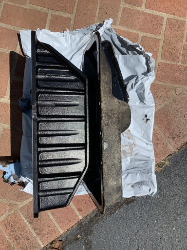

Today, I did something that didn’t NEED to be done, but couldn’t hurt to check off of the list. The Ex has been an East Coast car it’s whole 19-plus years and had accumulated a fair amount of surface rust on the frame and gas tank cover, including a few spots where the rust actually was starting to take hold. So, I out on my nitrile gloves, grabbed a large tarp and my wire brushes (hand and drill-mounted), and scrubbed the frame, skid plates, front and rear axles...and then coated everything with POR-15 rust inhibitor. Definitely not fun or easy, certainly messy, but it’ll be a little peace of mind when it gets salty on the roads or I take the Ex out on the beach!

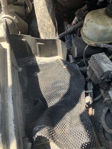

In the interim, it became clear that the, um, “unique” intake the previous owner was using wasn’t going to fly...it was simply a K&N filter laying on the inner fender, totally exposed to any water that might get in. As you can see, some muddy water splashed inside the engine bay during some Bald Mountain water crossings...don’t need anything other than diesel inside this ol’ 7.3!
Picked out an S&B intake...like how it was more of a “sealed unit.” Straightforward install.

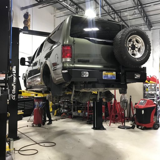

New rear bumper/spare tire mount from Buckstop Truckware:
...and an ARB single-screw air compressor (because we couldn’t find a good place to mount it inside the vehicle). Quick release is stored behind the bumper:
...and a BDS steering stabilizer to replace the junky Rough Country one:

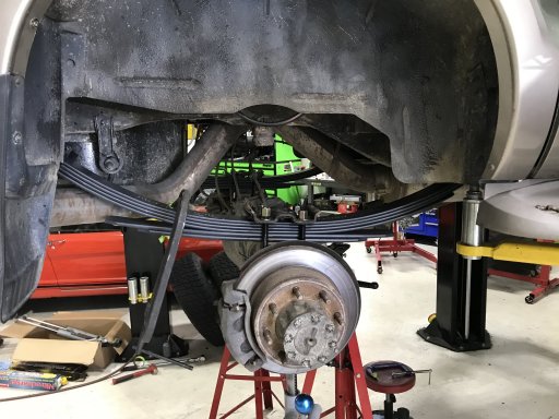

And then Creedence was off to a different shop that was willing to order/install ARB’s Old Man Emu full suspension kit:
The shop ran into a few issues with the 4” exhaust interfering with the passenger side helped spring, so they’re going to have to trim it a bit.
Also, full front end rebuild with Moog components, new Energy Suspension bump stops all around, gauge pod for boost, EGT and transmission temperature, and a Redhead Steering box.

Where is that new intake pulling air from? It looks like it's pulling air from the grille area. That could be really bad if you go through and moderately deep puddles. Eeek!
