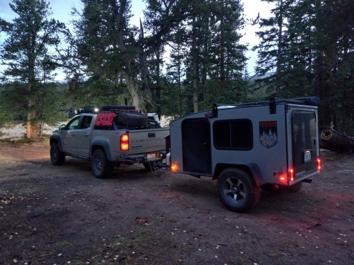

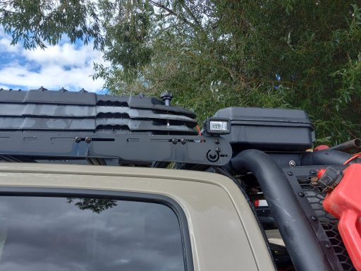

It's been a busy summer (we're up to 28 nights of camping so far!) but we're getting a list together of things to be accomplished over the winter. As it gets darker, lighting has moved up on the priority list again so I added side-facing LED lights and integrated them into the Auxbeam switch controller.
We are likely going to completely redo the bed rack this winter, so additional rear-facing lights and amber chase lights will wait until that is done.

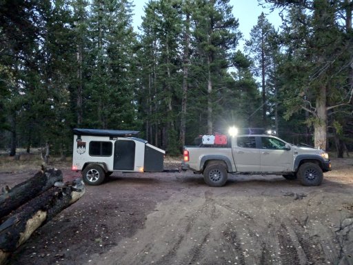

Well, after spending 35 nights camping and travelling this year the season has basically come to a close! We learned a couple of important things, some related to my inquiry from a few months ago regarding a MITS canopy. The biggest takeaway is that the Iceco fridge/freezer mounted on the tongue of our trailer definitely does NOT work out in that location since it's caused body damage during tight maneuvers TWICE:
Related to this, although we love the look of the prerunner-style tire carrier and bed rack it leaves absolutely no room for storing camping gear especially when we're leaving the trailer behind on a tougher trail. We decided we can't justify the cost of the MITS canopy as much as I like the Aussie way of overlanding, so we have settled on replacing the Armordillo bed rack and tire carrier with a Leitner Designs bed rack including side storage pods. We'll build a new solar power system for this rack and put the fridge on a tilting slide in the truck bed to get it off of the trailer where it has caused interference issues; this will allow us more storage of gear when travelling light without the trailer and allow us to have the fridge with us in either travel scenario. Parts are staring to arrive, so stay tuned over the winter for more build photos!
