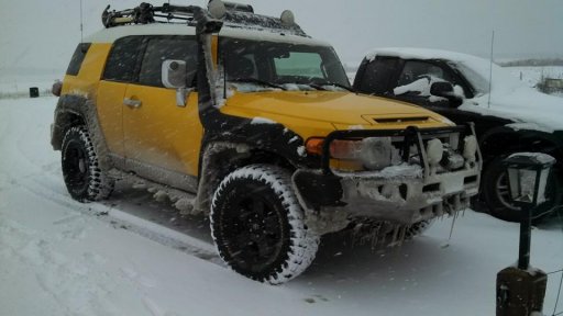

It's important to go over "where we came from" with vehicle builds. Our first rig that could be considered built for Overlanding - though that wasn't really a term in use at the time - was a 2007 Toyota FJ Cruiser in Sun Fusion Yellow. I ordered it with a manual transmission due to the flexibility that allows, and it came with front and rear lockers, Hella bumper and roof lights, the roof rack, and sliders. We slowly built it up until we sold it in 2014: ARB front bumper with Smittybilt winch, front leveling kit to allow 285/75/16 BFG Mud Terrains on blacked-out factory 16" wheels, ARB snorkel, a custom internal storage solution (not drawers, but more like cubbies/compartments) and ham and CB radios. We had a lot of fun with this rig, including doing an FJ Cruiser Summit in Ouray where we did Black Bear, Imogene, Engineer, Ophir, Cinnamon, etc. - all the famous passes. We also did a really fun trip to Yellowstone and through Idaho and Utah. We sold the FJC in 2014 because our family had outgrown it's admittedly cramped interior, and we sort of fell out of the off roading (now "overlanding") for a few years.
224783_10150160370273434_664887_n.jpg10296767_10152158055848434_3027080820099832254_n.jpg

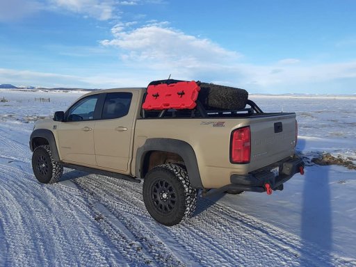

We brought the Bison home with the understanding that we now had a "head start" with the things we had been planning to do with the Z71. We now had more appropriate (not plastic!) front and rear bumpers, skids, sliders, etc. We knew we were trading fuel mileage for reliability going with the gas engine, but we chose the cat-back exhaust option for a little more fun. The truck came with the factory bed rack that we quickly deep-sixed for the Armordillo rack from the Z71 (we removed it before trade in). Our first new mods have been to mount a Rotopax fuel can (to address the fuel range reduction) and some off-brand traction boards on the sides of the bed rack. We used the Rotopax dual mounting plates on both side and added some hardware to hold the traction boards (a really easy mod) in case we ever decide to hold an additional Rotopax on that side. We bought the traction boards on Amazon because quite frankly they were a third of the price and had really good reviews compared to MAxTrax - and we try really hard not to get stuck in the first place so if these only survive a use or two that's fine.
144465437_10157944943373434_4462845144596293461_n.jpg144102501_10157948162778434_1586183102264411393_o.jpg

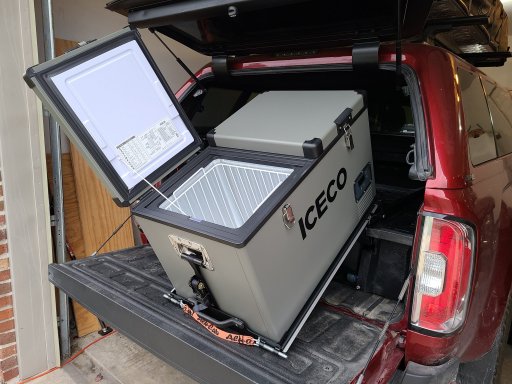

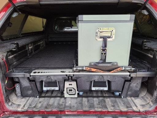

I think you'll like the Decked system, I have one as well and it's a great product for the money for people like me that have little to no woodworking tools or experience so building my own storage would end up costing more (literally and figuratively in terms of my patience). Having a custom-built storage done by a local woodworker would've cost twice as much as the Decked.
Install was easy, I was able to do 99% of it myself even with the topper on the truck. I only needed my wife to help out with providing leverage when trying to get the bolts for the lids into the nuts at the front of the bed since they didn't line up close enough to get them threaded in. I also ended up with one missing bolt for the lid and got two Left ammo can lids, so I shot them an email and they shipped me a Right lid and a bag of spare hardware no questions asked.
Been really happy with it, smooth operation, solid, and mounted my fridge slide to it without issue.

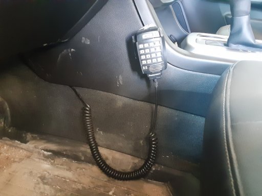

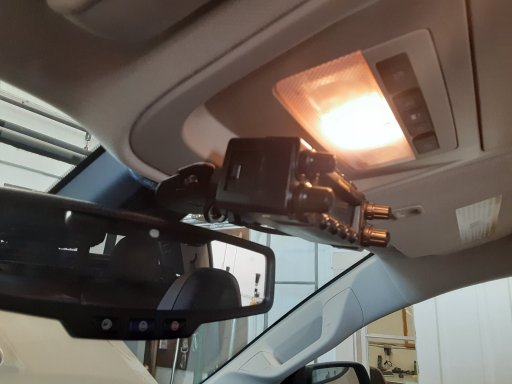

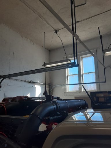

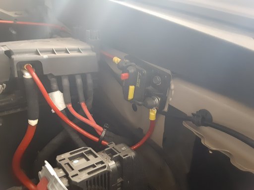

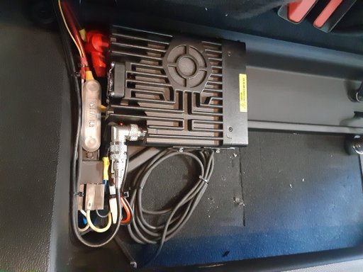

I finished up my ham radio installation today. It's a Powerwerx DB-750X dual band that is both Part 97 (ham) and Part 90 (LMR) certified (I do a lot of volunteer communications work with my county). Pretty basic setup: an 80 amp breaker under the hood feeds a power bus under the back seat (future expansion for CB, cell booster, and auxiliary lighting controller). A relay that is switched by an ignition hot lead feeds the radio that has its own inline fuse, and is also mounted under the back seat; the remote head unit is above the rear view mirror, the mic is on an extension cable and comes out under the dash, and the speaker is under the seat. As you can tell, I don't like cables showing :). The antenna is on a mount fabbed by me from a scrap of steel and is mounted to the bed rack in the back. Pretty much a run-of-the-mill installation.
20210302_145338.jpg20210302_145121.jpg20210302_145059.jpgResized_20210302_145036.jpegResized_20210302_145132.jpeg

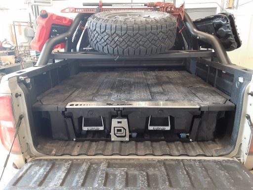

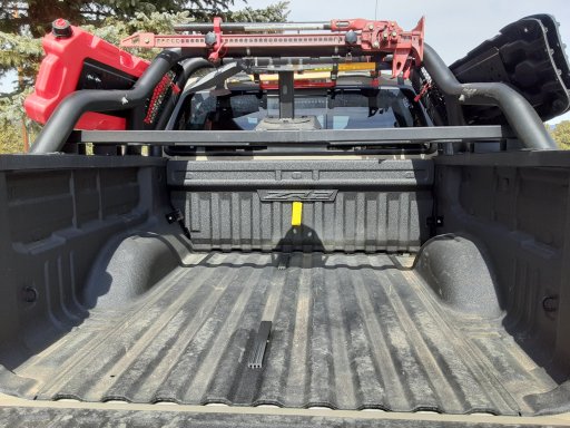

We installed the Decked system over the weekend. It's as everyone described - very straightforward and although it was nice having help to speed assembly and lift parts into place it could be a solo job. The only dig against Decked is we discovered one of the roller wheel axles was missing (probably fell out during shipment if I had to guess) meaning one of the drawers was sans a wheel for a few days. Big credit to Decked though - I called them first thing Monday morning and described what was missing, and I had the correct parts on my doorstep Wednesday afternoon. The left drawer will be dedicated to a permanently-assigned collection of tools and recovery gear that stays with the truck, and the two "ammo can" wells will be filled with additional recovery gear and some spare fluids that I don't want floating around in the drawers themselves. The wide drawer will be the "mission dependent" load - filled as needed for camping, hiking/snowshoeing, hell maybe even trips to the grocery store... It'll be the flexible storage option. We're still playing with loadout configurations, so that may be the subject of a future post.
Before - with the spare tire removed from its carrier:
After - with the spare tire back in place:
There's about a foot of clearance between the top of the deck and the bottom of the spare tire carrier, so the plan is to fit some plastic boxes we have for camping etc. right under there for a good fit; tents, sleeping bags, camp chairs, etc. will go in the space ahead of the spare tire. A cooler (and eventually a fridge/freezer) will mount to the deck aft of the spare. Need to figure out where to mount a 5 or 10 pound propane tank too.
