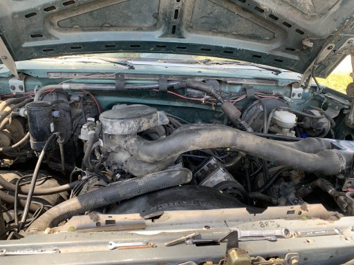

Well six months later and I finally have the engine in. I spent the day yesterday swapping over the exhaust manifolds from the old engine to the JY engine... only to discover the JY engine has a hole in the oil pan... so not sure what I’m going to do there... I don’t have a warm enough place to let the RTV set up...
Today it was just a matter of lifting the engine up and pushing the Bronco forwards.

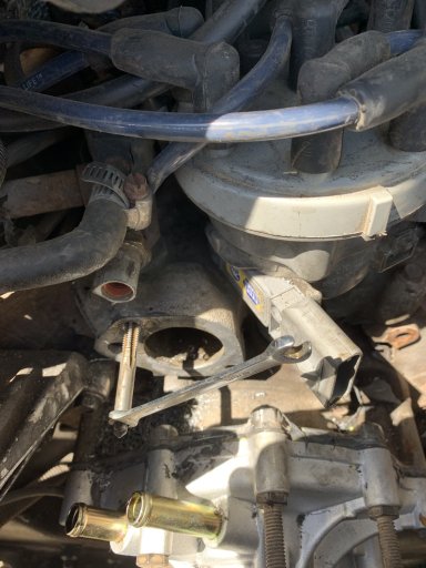

On April 28th I forgot to mention another problem I was having. On a short trip to the gas station the engine overheated. I thought I had air in the system so I burped the cooling system several times without any luck. In fact I finally got the coolant level to stay consistent, but would still over heat within 15 minutes.
The past two weeks I have replaced the water pump, fan clutch, and the thermostat. While changing the thermostat one of the bolts broke. I tried to weld a nut onto the protruding bolt without any luck. I ended up snapping the bolt off inside the intake manifold last week.
Today I was finally able to drill and tap the intake manifold. But the thermostat housing wouldn’t fit flush. I ended up using my old housing and a heavy coat of UltraBlack RTV. I hope I have it sealed up now... if not, I’ll have to carefully pull the intake manifold (again) to swap the lower.
The good news... I got my steering column, steering wheel, and my bonus instrument cluster in last night. So as soon as I get road worthy I can go pick up the rest of my interior parts so I can put the inside back together.
Tapping the Thermostat Housing
All Buttoned Up and Ready To Fill

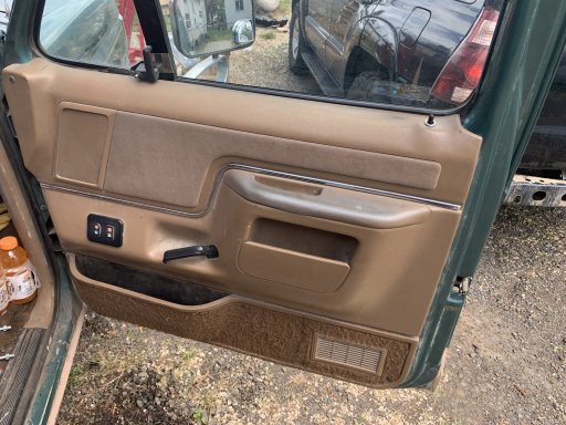

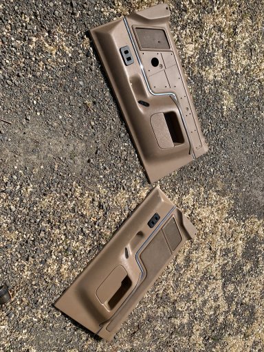

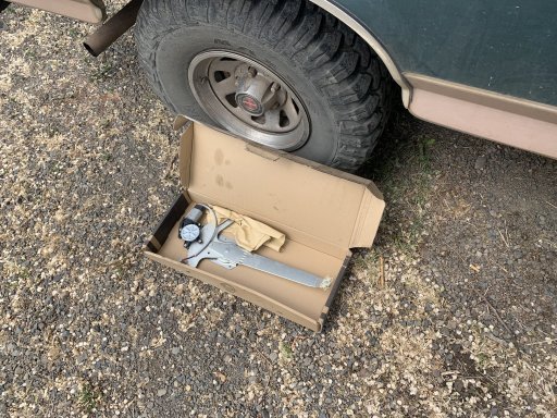

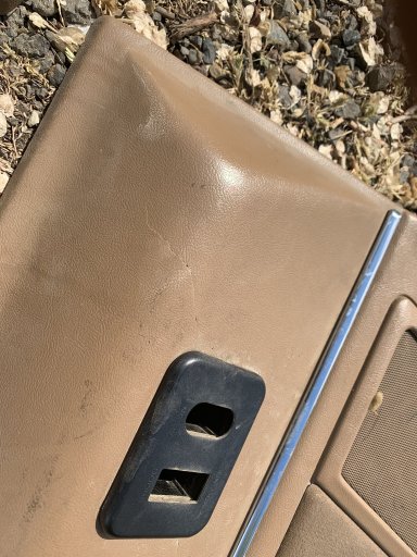

Over the past couple of days I have been focusing on the interior. Wednesday I installed both front seats. Thursday I swapped the driver side door panel and bolted down the center console. Today I installed a new window regulator and motor as well as swapped door panels. I’m hoping to move to the back tailgate soon to fix the rear window motor.
Cracked Panel... I should have taken pictures of the back side, I don’t know how it stayed on the door.
pretty close match in color if you ask me. (New on top, old On bottom
New window regulator and motor ready to go in
All buttoned back up

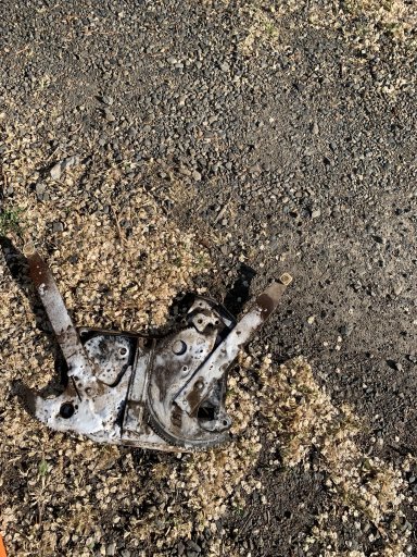

After the rain I decided to go back outside and try to tackle the rear window. Two hours later and the window now moves up and down on its own. I still need to rout the wiring better as well as rewrire the assembly as well. I have an internal brake somewhere, so it will be easiest to just make a new wire.
cleaning up the stuck window regulator
