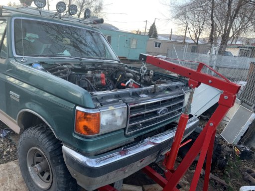

You’re two days late John, I picked up a engine hoist late Thursday night and rented it through till Monday. I would much rather barrowed one (or even bought my own) had I known how much the rental fee was going to be.

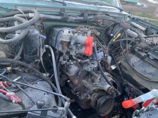

One bolt has me cussing up a storm... I have been trying for three days to get it loose, I’m to the point where in a couple of hours I’m getting under there and grinding the head off... it’s the last bolt holding the engine to the bell housing inspection cover... right behind the y-pipe on the driver side. It’s a tight spot that I can’t get my ratchet to, and my wrench rounded the head off... I’ve tried vice grips and heat and it still won’t budge... I have to get the engine out today... but I can only work in small shifts due to the smoke.
After the bolt, all that is left is removing the hood before I can pull the engine. Then I should be able to pull the transmission out shortly there after...

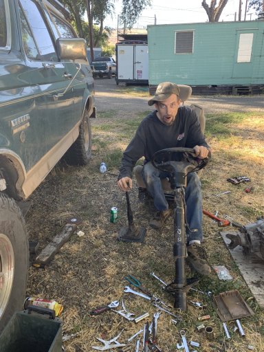

I finally got the engine and transmission out with the help of my neighbors. Sunday I am going to empty the cab and disconnect my steering column and install my clutch pedal assembly.
Next week I will be swapping parts over from the old engine to put onto the new one, and hopefully will have a running engine by this time next week.

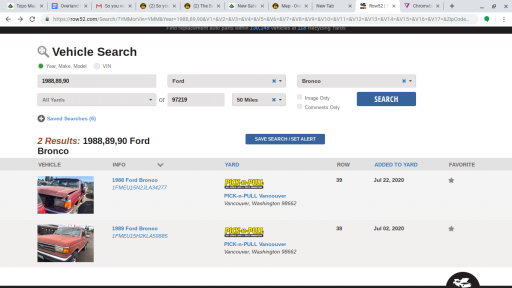

Thanks to an unexpected visitor today I finally got my donor delivered today.
Thanks @St0ll3n for borrowing a mutual friend’s F-Word to help me pick up the new engine...

Well six months later and I finally have the engine in. I spent the day yesterday swapping over the exhaust manifolds from the old engine to the JY engine... only to discover the JY engine has a hole in the oil pan... so not sure what I’m going to do there... I don’t have a warm enough place to let the RTV set up...
Today it was just a matter of lifting the engine up and pushing the Bronco forwards.
Tomorrow is going to be getting the transmission ready to put in.
