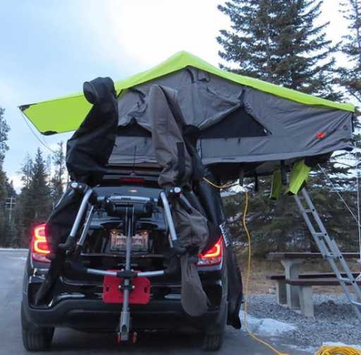

So with my budget i just picked up a heated blanket for temporary use until i buy a heater.
I used it once already in my RTT in Banff on a -16 Celsius night. Worked perfect ontop of my sleeping bag.
I did manage to get a camp spot with power so that was convenient, otherwise i would have used the plug-in inside the trax.
My tent is made by Treeline here in Canada. Its an all season tent so its completely weather and wind proof. It alone acts as an insulator so i can sleep in it just below freezing with out being cold.
Pic shows the extension cord i used and fed into the tent for the blanket.11.png

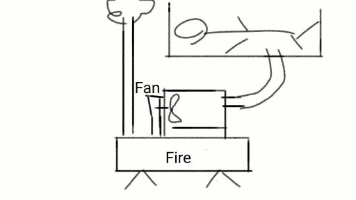

I'm working on an idea simple but may work well. Will be using a army stove filled with charcoal. Get it nice and warm before bed. I will create a duct system up to my James Baroud tent. I will use one of the wood stove self propeled fans attached to the duct and stove to keep the air moving in. sketch-1520950368097.jpg

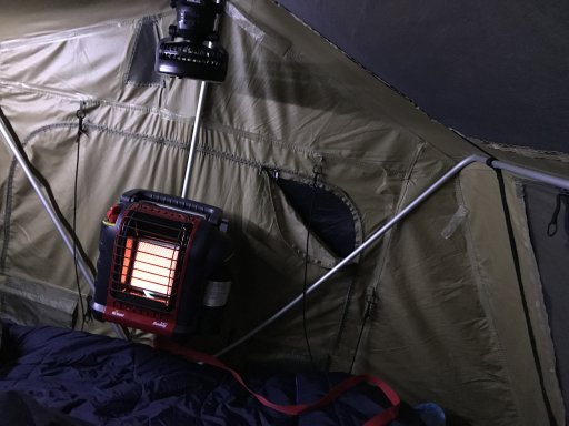

I finally wimped out and bought a Buddy heater. I already had the fan hanging over it for warm weather camping, but it helps to disperse the heat well. Honestly, this heater is WAY too big for the standard rooftop tent. At the time of purchase, it was the same price as the smaller model, so it seemed to make sense, but I'm questioning that. I may downgrade at some point.

I'm working on an idea simple but may work well. Will be using a army stove filled with charcoal. Get it nice and warm before bed. I will create a duct system up to my James Baroud tent. I will use one of the wood stove self propeled fans attached to the duct and stove to keep the air moving in. View attachment 50782
Sent from my Moto Z (2) using OB Talk mobile app
This guy had basically the same idea: I like your idea of using a fan powered by the stove though!
