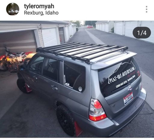

Cool build man! We did something similar with ours :) View attachment 85370
Looks fantastic, dude! Love that sink setup. Nice to have everything - including the kitchen sink - inside a Forester, ain't it? ;)

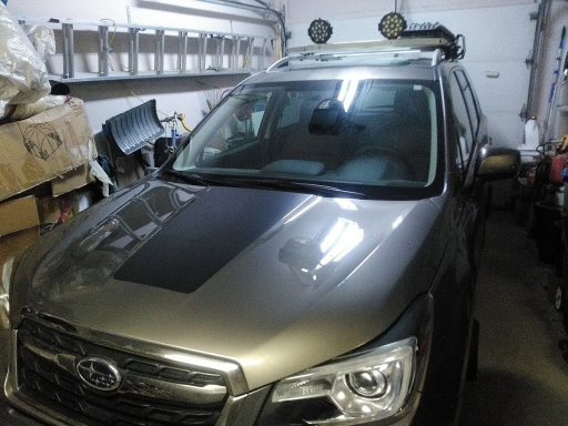

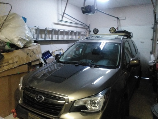

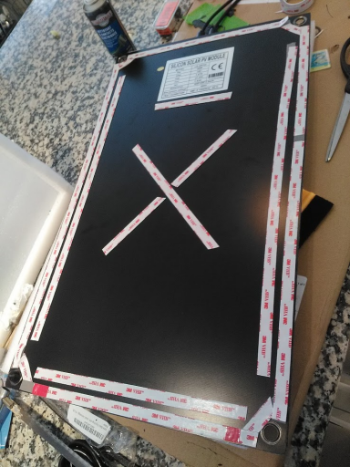

Been a while since I last made an update... Things have been keeping me busy at university, but I had time to install a solar panel!
92166
Began with some vinyl wrap and knifeless tape to follow the contours of the hood bulge.
92167
I then applied 3M VHB tape to the rear of the panel. The VHB will adhere to the vinyl; so if I need to remove the panel, I remove the vinyl, and not my paint job.
92168
I sealed the edge with silicone, and am waiting on a new solar controller. Once that gets here, everything will be wired in.
92169
Thanks for looking! Better pics will be here soon.

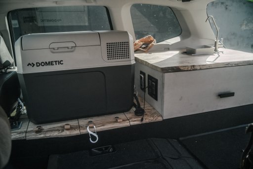

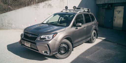

Took some pics of the rig today:
96767
Really enjoying the solar panel. It's 30W and keeps the spare battery float charged, plus it can run the fridge. Add some portable 60W solar and the fridge can run indefinitely.
96772
Went to a lot of work to make sure form follows function. The fridge is latched down tightly, but can unlatched relatively easily to access some compartments underneath, or just removed. The sink (a repurposed stainless steel flowerpot) drains to a small grey water tank, and out through a port in the bottom of the vehicle. The spare tire will be moved to the outside - "the hold" it was in has been emptied, and provides A LOT more storage space. Also, the moose head/bottle opener swings out for easy access.
96773
The pull tabs are some inexpensive leather ones from IKEA. They look good, and make it much, much easier to grab stuff with winter gloves on.
96774
Princess Auto has these great stainless steel pop-up tiedowns for truck beds. They're half the price of most others, in their clearance section, but much better quality, IMO.
96775
The fridge, ampmeter, 110v outlets, 5v outlets, and switches for the pump/filter and inverter. I've had this fridge for the past month, and really enjoy it. Definitely one of the best things I've spent my money one, just wish it had proper anchor points. Right now, I plasti-dipped the ends of some carabiners, so they don't cut into the plastic handles.
With the inside more or less complete, I'll be adding a 2" front, 2.5" rear lift, plus skid plates.
Thanks for looking!
