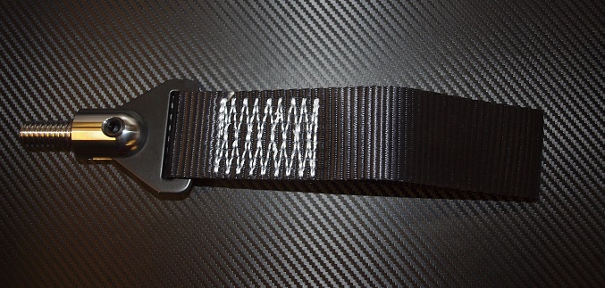

Regarding towing; are you thinking of these straps?
or more like this?
I'm also considering replacing the "5mph" bumper with a winch mount that includes recovery points, sort of like this:
Thoughts?

Glad to help! Just this past summer a group of Subaru’s in the northeast dodged a bullet during a dynamic recovery with WAY too heavy of a snatch strap. No line damper but thankfully no one was in the line of fire when the stuck vehicles recovery hook failed. The steel shackle slammed into the back of the Forester attempting to yank it out. Steel shackle, too heavy of a strap, and no line damper. Bad situation but I digress.
This is what I was referring to. They’re so light they float on water yet somehow freakishly strong.

With Primitive you have the option of either 0.125 (1/8”) or 0.188 (3/16”) @Baipin but I think it’s great that you want to make your own.
For use as an extender you want zero stretch so yes a tow strap is better suited. Not to mention a tow strap is a good part of any recovery kit.
As far as a dynamic recovery causing damage I’d say with confidence that inexperience and/or improper equipment played a roll. In the aforementioned incident both an improper strap and inexperience resulted in damage to both a Forester and an Outback Sport. When used properly a kinetic recovery increases extraction force while essentially eliminating the harsh shock load.
A good recovery kit is only as good as it’s contents and the knowledge to use them. A dynamic recovery strap/rope is an amazing tool when properly sized and applied. Sizing is certainly the easy part. The proper size is based on the lighter vehicle involved in the recovery which 99.9% will be us. What isn’t as easy is finding the size we would want. I’d highly recommend a kinetic rope over a strap for two reasons. The first being that they stretch more. The second is that it gives us more options. This is the rope I use...
Bubba Rope (176653) Sidewinder Xtreme, 5/8" x 20' (Blue)
Less easy is feeling comfortable properly using it. It’s a strange thing to have faith in but you can watch countless mind boggling rubber band videos on YouTube haha. In the case of the rope I use it has the ability to stretch from 20’ to 26’. There’s no substitute for training or experience but the important thing to remember is that you don’t have to go all in the first time. You can always back up and try it again a little harder. You can also add a tow strap if you need a longer reach. Double up the strap you bought and you can now reach 35’. Don’t double it and it’s 50’. The important part is that the rope in the ‘chain’ to do its job. Last but definitely not least... use a line damper. You can buy them or you can make one. Hell you can throw a heavier jacket over the line but do something to help drag that line to the earth just in case things go south. Safety first.
I apologize for clouding up your build thread. We can continue here if you like or please feel free to DM me with any questions you might have. I, like many others in this community, am always glad to help. Also feel free to check out my build thread. You may get some answers to questions you might have or perhaps generate some new ones haha.
No worries about cluttering my thread haha - your tips, questions, and answers are all generously appreciated!
I've decided to keep the tow strap and will consider a recovery rope in the near future. That, along with a winch (Princess Auto has the often-recommended 4500 lbs Superwinch on sale) a fridge, a 1.5" to 2" lift, and most importantly; some armor. I'll see what prices for skid plate aluminum are around here. The local junkyards usually have a few big pieces lying around too...
