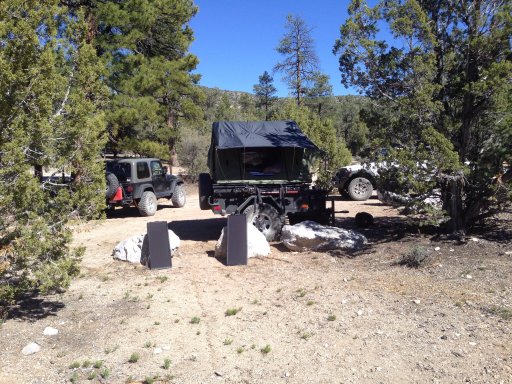

My setup is an ARB fridge plugged into a National Luna power pack with a deep cycle. When the truck is running, the motor charges the pack and then the fridge runs off that. If I'm on a camp trip where the truck (Tundra) is going to be sitting for more than a day I throw out two of the Goal Zero hard panels. On a recent three day stay they kept the pack topped off despite solid overcast days. Prior to the hard panels I used one of their folding panels that would just barely keep up with the fridge with good sunlight.

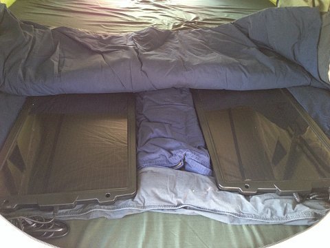

I picked up this 45W setup from Harbor Freight for around $150 a few years ago. Keeps the battery in my tongue box charged and the charging control unit has multiple direct charging options. The solar panels easily store in my RTT. For a cheap set up, it's holding up well.

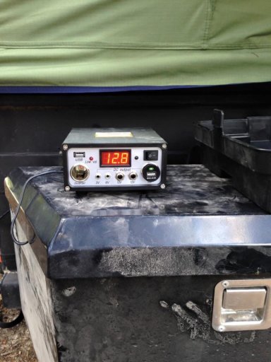

I have an Indel B fridge powered be an ArkPak using a 105amphr AGM battery. I also have a Renogy 100w solar suitcase with 25' of #10 wire connecting it to the ArkPak via 50amp Anderson power pole.
While driving I plug the fridge into a 12v socket in the back of the Jeep and charge the ArkPak via the smart charger off a 12v plug in the front of the Jeep. In camp, I plug the fridge into the ArkPak which lasts about 4 days before dropping to 50%. On a sunny day I can park the Jeep in the shade and deploy the solar in the sun.
