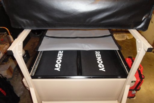

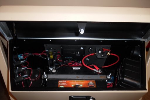

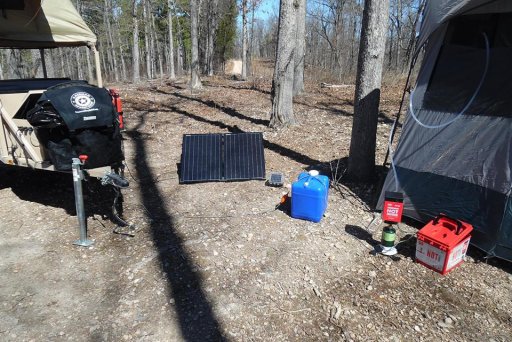

my 1st build (2 yrs ago) I went with all Renogy. 2 100watt portable suit case panels, 15ft 10 awg cable, 5 ft. 10awg cable branch connector to run both panel parallel which increases the amps but the voltage stays the same. 30amp Renogy Charge Controller w\ battery temperature sensor that supplies power to 125ah VMax Tank AGM battery. I have more than enough power to run all my 12v. gear & equipment w\ a full reserve for night time hours. What I like about my set up is I can run both panels or use one panel for less 12v. gear.

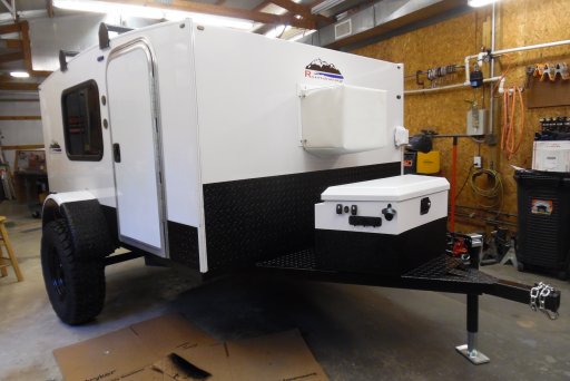

My current project offroad Runaway Range Runner 4th pic I'll be using the same exact set up, it's reliable.

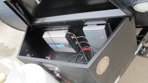

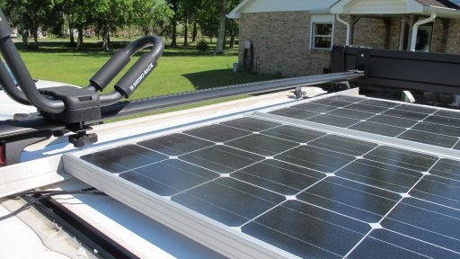

I recently set up my overland trailer with (2) 100 watt Renogy panels and their MPPT controller. I bought a Harbor Freight tongue box and added marine grade vents to it and a HF 2000w inverter. I mounted the panels on top of the Rhino rack rails so they are about an inch off the roof and still under the Rhino rack bars so I can still use the rack system with no problems. The set up works great and I charge a lead acid battery with it but will upgrade to a 200 amp hour glass mat battery. I ran a 120 vac shop fan off the inverter and watched my charge controller...the 200 watts solar almost ran the fan without needing to draw from the battery. The inverter easily runs a blow dryer and power tools. Not too bad for a few hundred bucks.
