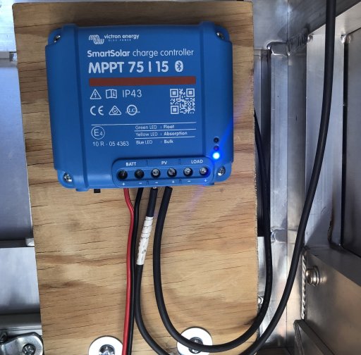

Yesterday I completed a solar panel install on top my pop-up camper, using a SunflareSolar flexible panel and a Victron charge controller. The Victron controller powers a Powerworx PWRbox with an automotive 12V socket and two USB ports. Everything works.
The Victron controller has a smartphone app too.

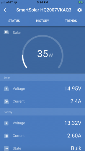

Cool! The smartphone app sounds interesting. What functions and features do you have wit that?

Everything you see on the smartphone screen plus HISTORY and TRENDS.
You can also setup smart networks between various Victron devices, say if you have a DC-DC charger, MPPT charger and a SmartShunt, they can all communicate. Granted this is still in development, so as of right now it's mainly the SmartShunt and MPPT SmartSolar controllers.

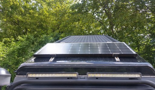

I am having a solid 100W solar panel with aluminium frame on the roof of the rig for about ten years now. Have mounted this on airline rails. There are extra mounting brackets for this mounting solution available. This works absolutely perfectly for me. There is also no wind noise. Additional height is minimal. The advantage of this mounting is also that the module gets ventilated from underneath, so it doesn't get too warm in the sun (which can affect the performance of the module). Here is a picture of it:
