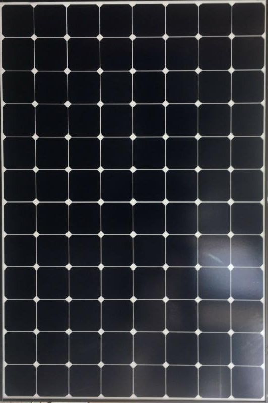

Brand New SunPower P17 340W Panels $110!
MAJOR discount on these brand new panels!​
  • Multicrystalline Cell
  • Higher Performance due to row-to-row shading tech
  • Parallel circuitry limits shading loss to the shaded area only
Used SunPower 327W Panels $100!
With a smaller frame, these panels pack a punch!​
Brand New SunPower P17 335W Panels $105!
These are almost gone! Get them while they last!​
