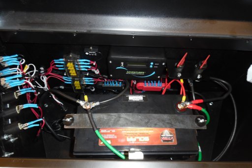

solar is a personal preference, used Renogy on both trailer builds, I like their technical support. They are their when I need to call for a question, their product serves me & the wife well with both trailers I've built. Charges my 125ah VMax AGM battery no problem, so I can run my Engel 40 qt. portable fridge, supplies power to my Proplex furnace, Endless Breeze Fan, Zodi hot shower system, charges a cell phone, & GPS unit. Their portable suit case Monocrystalline Solar Panels are top quality for full sun & partial sun, the hard case for the panel is top quality, Renogy 30amp Adventurer Charge Controller gives me capability of charging my AGM battery like I mention as well Lithium batteries & flooded batteries, not counting the options to add on more solar panels up to 400watts. It monitor's the temperature of the battery, & what power is coming in & going out. My 1st trailer build I used their Wanderer 30amp Charge Controller with VMax 125ah AGM & it charges deep cycle sealed, Flooded, & Lithium battery too.
Zamp Solar make a great product as well as Overland Solar. It's all personal preference. I use what I know & have had great success with.
