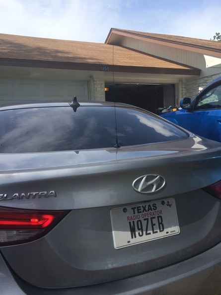

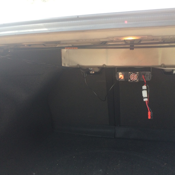

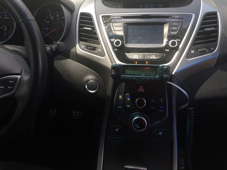

You can set up a ham radio station anywhere!
On a beach...
...in your overland rig
...or at home.
