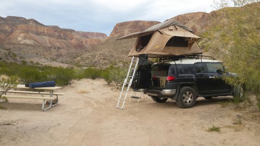

I just mounted the newly purchased SmittyBuilt Overlander XL tent on my FJ Cruiser. This is supposed to be a budget friendly RTT. I purchased it and an annex from 4WD website. I have not used it yet and plan on going out in it this weekend.
Has anyone out there purchased this tent? Any honest reviews ?
It seems very rugged and heavy duty. I am curious how it will hold up. 20180619_204021.jpeg20180619_203931.jpeg20180619_203919.jpeg

I have the regular Smittybilt RTT. It has done well so far with about 20 nights camping in the last 18 months. Beware of the straps...they are crap and break easily so don't tug too hard on them. I will eventually replace them all. We took up the mattress and cut to size some Dow foam insulation to place between the mattress and the base. Made it much more comfortable in winter camping, and eliminated the sweating issue under the mattress. Cheap easy fix. The new model Smittybilt tents have improved dramatically from their 1st gen tents, and when on sale are a great value. Enjoy.

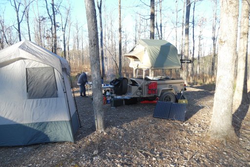

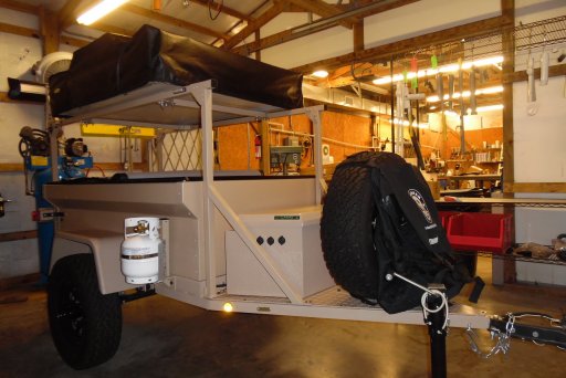

When in search for RTT @ the 1st of my trailer build last year, I looked & researched many of them out their. Designs & materials were pretty close to the same. Price isn't a issue with me. I heard from forums that Smittybilt Overlander Tents were junk. As "for me" I do not always believe what I hear or read. But when you go on-line & check out actual reviews they say a different story, other wise positive reviews. The reason why I purchased the Smittybilt Roof Top Tent was I have a good friend who works for them (NO I didn't get a friend deal either). Their was also some video's on you tube that kinda help me decide to go with Smittybilt by 410 Expeditions "Cappy" about the 1st Gen Smittybilt RTT review & a second review on the 2nd Gen Smittybilt RTT he made. These video's pretty much sealed the deal with me. Smittybilt has been making vast changes & improvements to their product lines & contines to do so. What verifies this even more is that Smittybilt made a huge improvement on the Annex for the 2783 tent by moving the entrance to the annex over to the side, when it used to be in the front of the ladder.
Watching both of those video's plus talking with my friend who works for Smittybilt the vast improvements Smittybilt continuously makes on there product line is only a good asset & shows me they do care about their products.
Now the mattress stinks, no if's, and's or but's about it, it is flat out uncomfortable. But what I read about "most" RTT mattresses seem to be this way. But after researching for a new mattress & reading about make shift solutions on forums I decided to go with a new whole mattress: Exped Duo Mega Mat 10 Queen Size extra long\extra wide. This mattress is like sleeping on my home mattress which is tempurpedic mattress. https://www.backcountry.com/exped-megamat-duo-10-sleeping-p…
I own the Smittybilt 2783 RTT for some time now. My overall review of this tent from "my opinion" when I 1st purchased it to now with many trips & nights slept in it from cold night down low as 23 degrees & hot southern summer nights in the 80's & in windy rainy conditions w\ the new mattress that aids in comfort to our RTT is a win win for Sally & I. The tent is structually sound & IMO will give years of use w\o issues., assuming the typical little things will go: velcro straps & small items which IMO are give me's to any RTT which in time from continuous use will need to be replaced or fixed.
IMO a good quailty anti condensation mat is a must, which mine is a CVT mat, & a shoe hammock instead of that horrible designed shoe bag. The shoe bag we used to store our Coleman collapsible oven in. What I like & think that works for Sally & I is any personal mod's or add-on's to the RTT only makes for more of a enjoyable & memorable camping trip.
Compact Camping Concepts sells these shoe hammocks. https://compact-camping-concepts-2.myshopify.com/…/tent-sho…

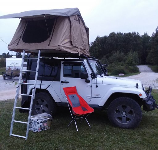

My wife and I absolutely love it! So happy that we don't have to struggle with a zipper to hold the cover on like some other brands. Velcro closure is no joke! The tent material is a touch lighter than some of the more pricey brands but still just as heavy as any quality ground tent material. I do wish the LED light strip came with a switch in the tent. Other than that I have had ZERO complaints!!!34416366_10211745431211382_334594668371116032_n.jpg
