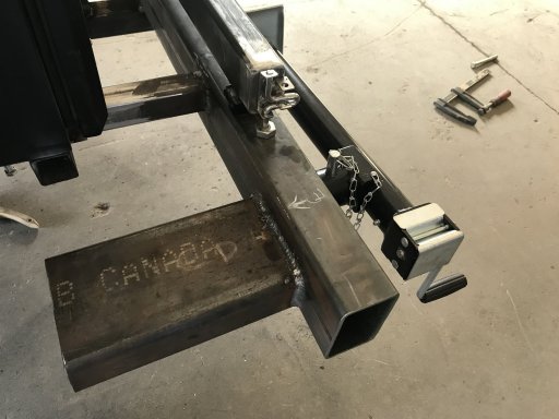

A few updated photos. Need to put on end caps on bumper, move license plate and light up higher about the tank. Waiting for the Rotopax so we can finish the bracing next to the Spare.

Nice! I "get" the length of the bumper now. Was scratching my head in early pics. Are you planning to tie into the fender with a tube to avoid getting hung up on it? Great low rearward place for some heavy stuff to address tongue weight...
Nice fabrication skills on that latch.

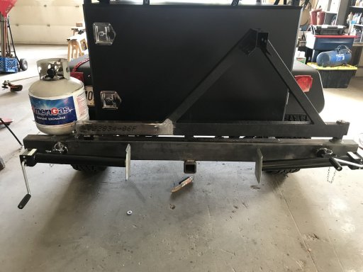

Rear Bumper and Swing photo update. After we got things cleaned up and in place, decided that (4) 3.5 gal Rotopax will fit in very nice. 3 between the spare tire and one next to the spare. Propane tank mount is really good. Had a very hard time to find a simple 20# tank mount that was not over $150. Ialso did not want to buy a 5 or 10# tank and keep it simple with the 20#. I will post a mounting photo later. It is similar to the Rhino Rack mount.
Gate works very well and we end up with a lot of extra forward space.

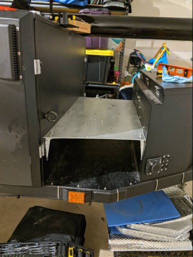

Hey all. I removed my spare tire and added it to the rear hitch. Decided to build some storage. Waiting for the latch to come in to finish each end.
I basically made it to store my camp chef dual burner stove. I really dislike how small the scouts slide out stove is.
I plan to connect the taller side of the main compartment into the small tongue box for additional storage. View attachment 133726View attachment 133727
