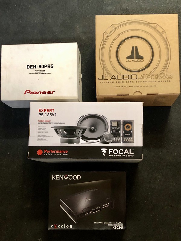

Headunit: Pioneer DEH-80PRS
Amp: Kenwood Excelon x802-5 (5 Channel)
Sub: JL 10TW3
Components: Focal Performance PS165v1
sound deadening: Dynamat extreme, ccf, heat shielding, etc.

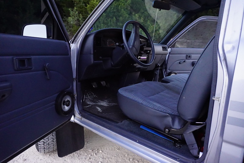

original dash and HU -

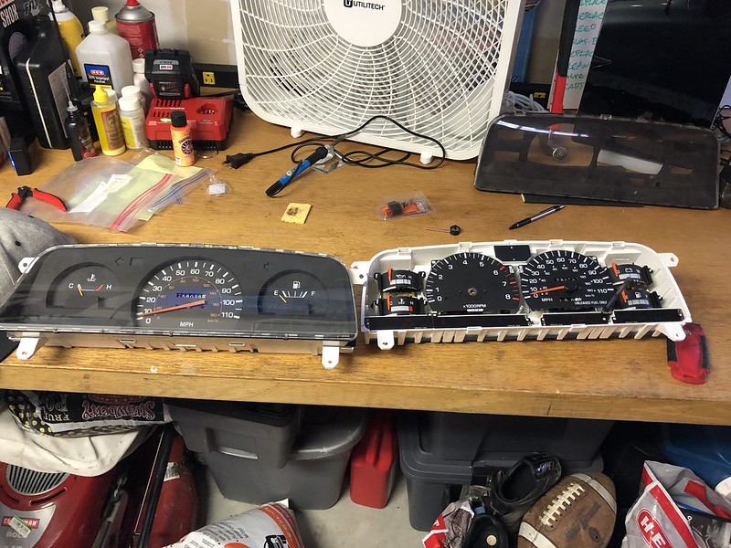

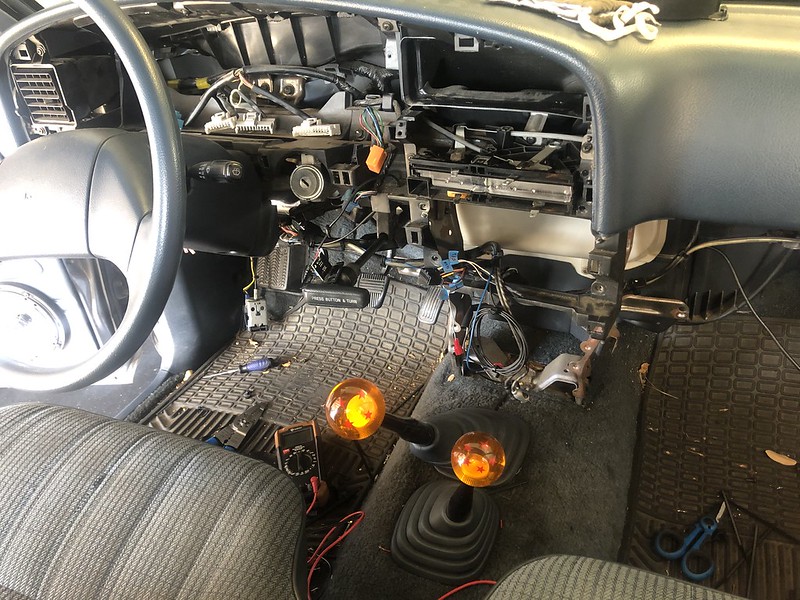

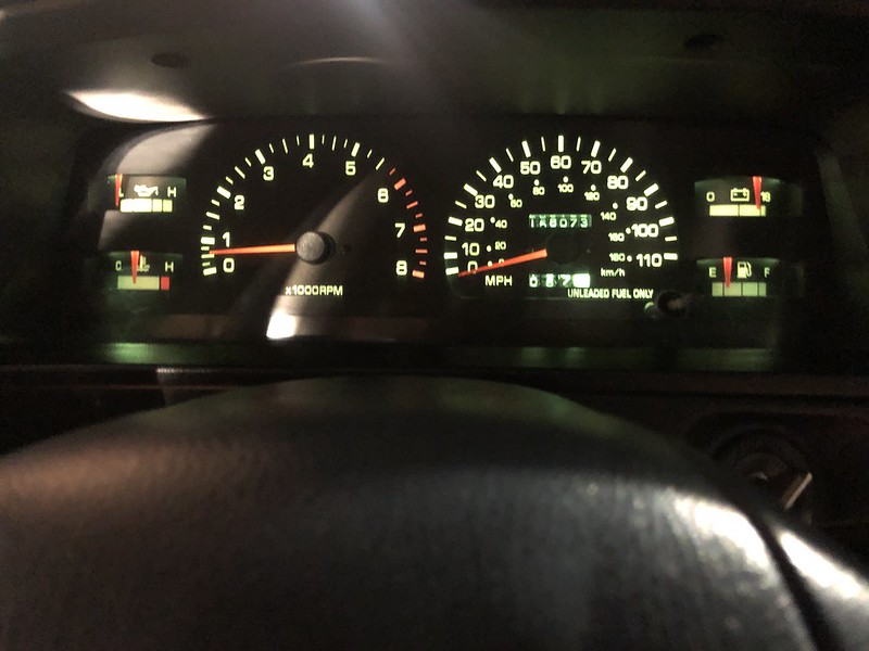

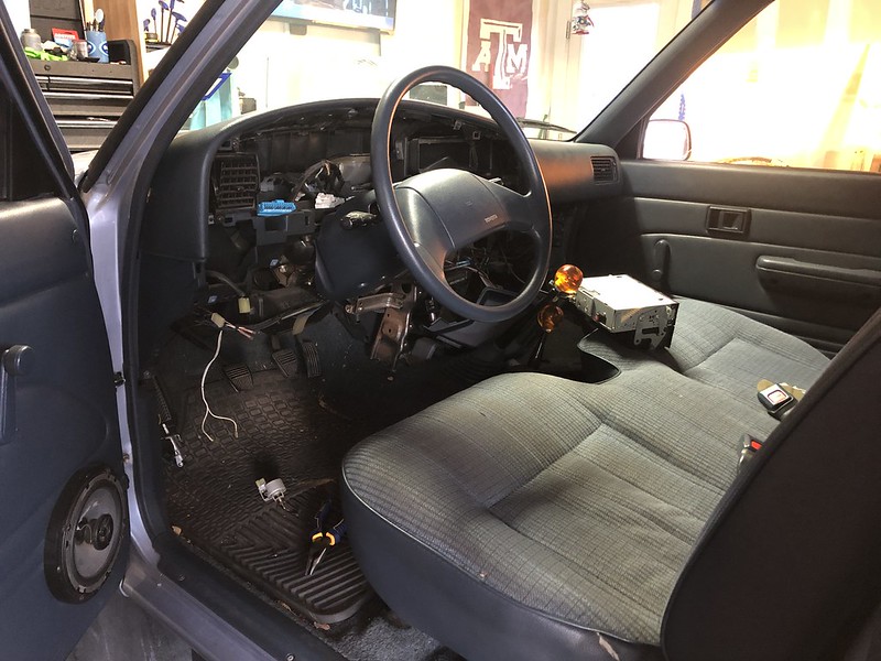

removed the dash to install a new gauge cluster with a tach and some extra gauges.

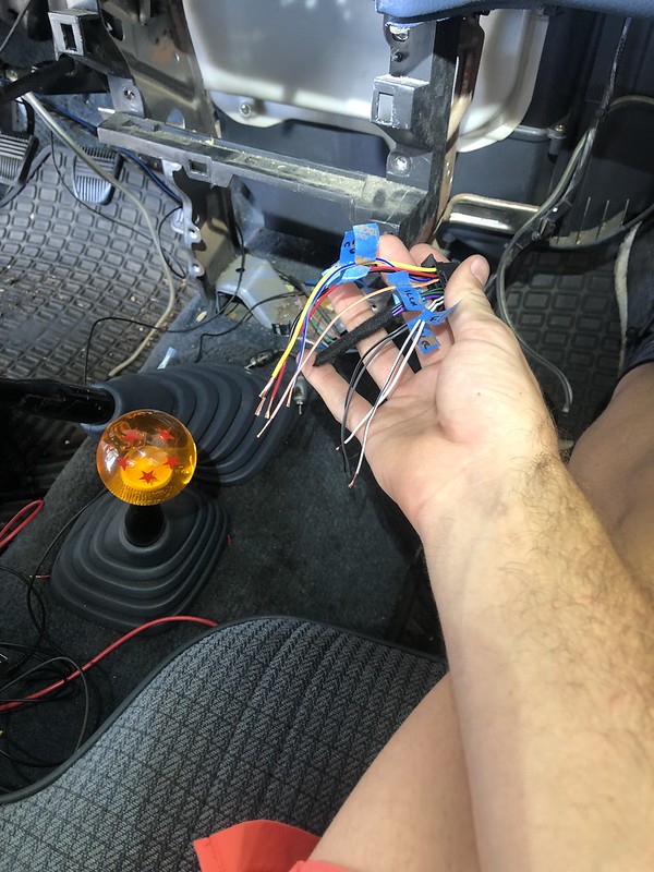

Spaghet:
no more spaghet:

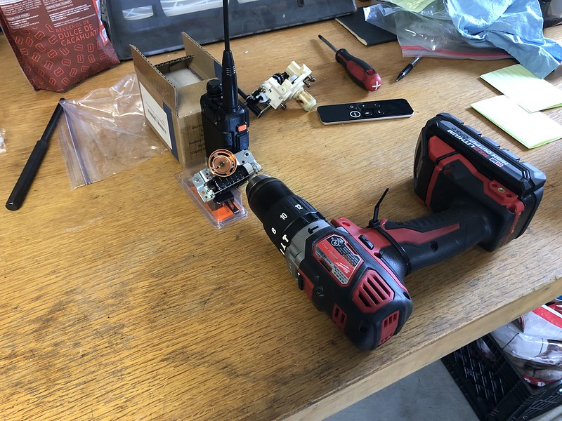

the odometer on the new cluster was 8000 miles low, so rigged up a setup with a drill, the worm gear, and some zipties to roll the odometer forward to make the new cluster match the old one that came out of the truck.

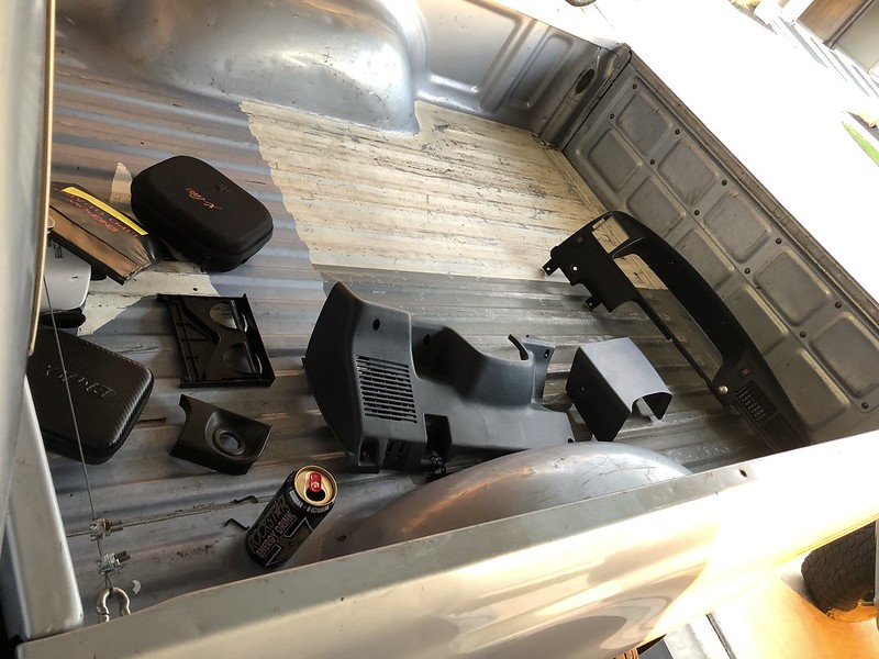

removed all other dash parts to remove old crappy kenwood headunit.
it ended up having an HD radio antenna hardwired in. i'll have to order a new antenna cable for when i go back in to run RCAs to the new amp in the next phase of install.

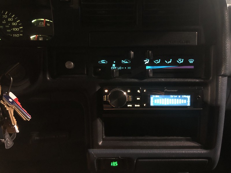

HU and new cluster installed:
i'll do glamour shots again when its all installed.
