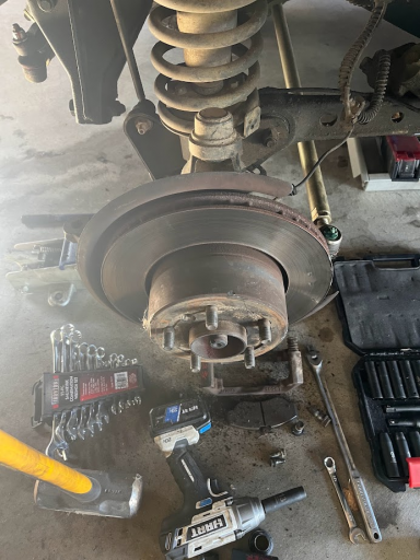

LF torn completely down. CV axle out. These had a couple spots of torn boots and I figured as worn out as other suspension/driveline components were, how good of shape could these be in. RockAuto had these cheap enough I was surprised and figured some new ones would make for some good prevention and peace of mind. I learned the hard way on these axle seals the correct tools are WELL worth their investment, even at $15 the seal puller made quick work of a job I was trying to do with needle-nose and a screwdriver. The press kit was a Harbor Freight special for about $40, and after trying to install the new seal made that job super quick.

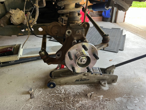

LF hub completed with some upgraded brakes, first test drive to see if this resolved my noise. I can't explain how improved the ride is, it was a 'wow, I didn't realize this thing could ride this nice' moment.

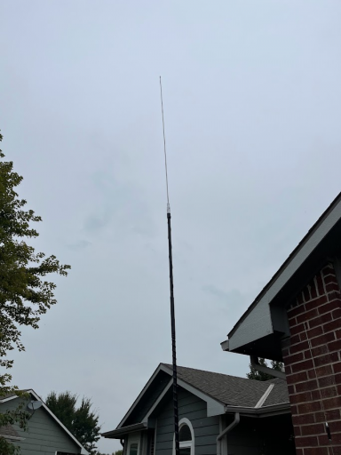

I really enjoy the amateur radio Parks on the Air (POTA) program. I don't always have tons of time or desire to spend time setting up/tearing down my station, decided to make it as easy as possible for quick HF setup. I used an NMO mount, NMO to 3/8-24 adapter and HAMSticks to accomplish that. Here's my 20M stick setup, I was able to get this tuned darn near to 1.1:1 on the center of 20M band.

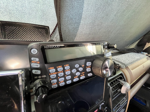

Here's an up-close of the HF transceiver I run in the truck, a Kenwood TS-480SAT. I opted for this due to the nice removable head and dual antenna connections. My goal is to have a dedicated/permanent 10M/11M whip off the front bumper and secondary being the hamstick in the roof.

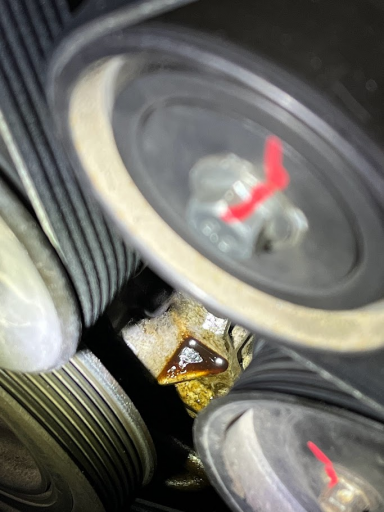

Early December it developed a misfire on cyl. 3, an acute (and significant) oil leak, I also noted it was WELL underpowered in comparison to my stock '02. I wasn't able to identify the oil leak location easily but it seemed to be the front of the motor. Without a good look and thinking front cover, galley perhaps - I dug in. Sure enough, it seemed to be the front lifter galley gasket. With a myriad of issues I've decided to push further and just do heads while I'm here.

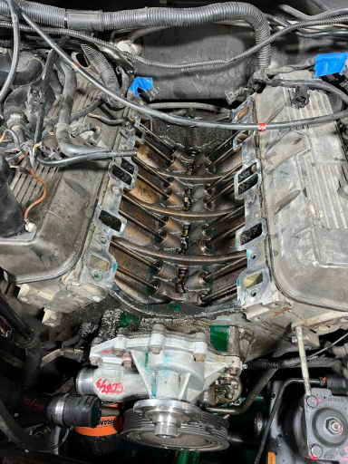

With this identified, we dug in. I exposed the galley and didn't like what I saw on the cam lobes... so, this continues to build into a larger job.
Heads are pretty gummed up. Pretty obvious this thing ran hot for a bit and didn't have the oil changed for too long of an interval. Lots of hard deposits in the valve-train which I wasn't a fan of.
At this stage with the issues I came across and known poor performance, I'm giving this engine a nice refresh through and through. Not having the '02 in comparison I probably would've just lumbered along but the lack of performance on this Rover in comparison leads me to believe a refresh should liven her up a bit and is overdue. Here's the plan so far as I've dug in...

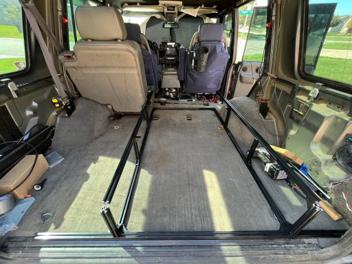

Moving along to the end of 2024, I started mocking up a not-so-fancy rear storage/sleeping platform solution. Very much function over fashion, but it ultimately came together. I was pretty satisfied the Rover was mechanically reliable at this stage with a few hundred miles of shakedown driving around the area. Earlier in 2024, I parted ways with the 2002 Discovery as it let me down daily-driving in a very inopportune time - the CFO of the household stated we weren't going to own two 25'ish year old machines to be used as daily drivers, to which.. I didn't fully disagree with. We welcomed back home my 2015 Sierra following a stint with a close friend in the PNW, my prior overland machine and DD. Progress slowed drastically on the Rover work due to school and having my Sierra back.
That said, even with slow progress - the minion and I continued our exploration, shakedown, and enjoyment of the Rover. He was still pretty young at the time to camp in it 'easily' so we took a series of day trips. I removed that 60 side of the rear seat, and he was unable to fit in the 40 side so I disconnected the front passenger airbag and he assumed co-pilot roles from a secure point. One afternoon following a trip to Teeter Rock, he told me he 'loved the Rover'. So I guess now I can't sell it!
During the process I installed a manual oil pressure gauge, forgot to include a shot of that earlier - needless to say, I was pleased with idle and running pressures.
We took a nice day trip to the Randolph ORV area near Manhattan, where I was reminded how much I need to get lockers installed and/or fix my dang TCS... The minion stated he 'loved off-roading' after this trip, so that's a solid second tally for not selling the Rover.
Fast forward further along, here's the rear sleeping/storage platform. I applied some foam mats for basic coverage. Sleeping is done on top of a 4" memory foam topper. There's just enough room for me to lay with my legs over the center console and the minion sleeps to my side. It's cozy, but it works! With Kansas wind and weather changes, I've come to enjoy sleeping in a vehicle or trailer of some sort. On the back door, I custom cut some aluminum to fit (the truck didn't have a rear door interior cover when I bought it) and added a fold down cooking surface.

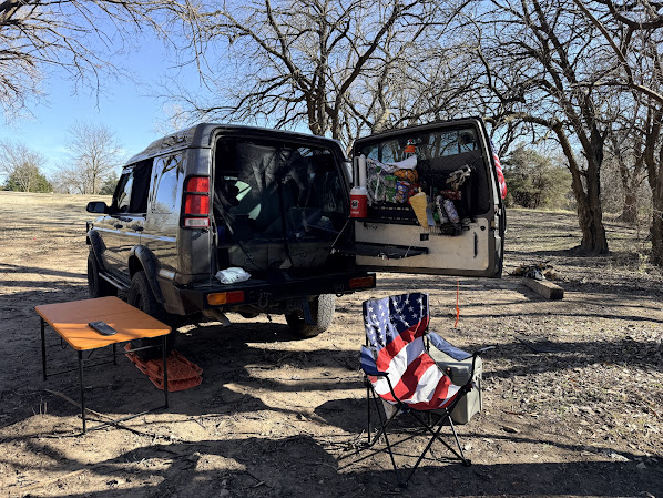

Now the fun stuff! I finally got the minion out to do some camping. We started a bit early in March, so it was a chilly night. I have one of the 'Amazon specials' diesel heaters and man did it work great. I had it on the lowest setting, sipping diesel and having enough power to run for an estimated 42 hours straight, according to my EcoFlow. We stayed nice and cozy all night. At one point, I woke up and took this picture of 48 outside and a nice 68 inside - it got cooler that night.
Here's pictures from that first camping trip I took with the boy! He LOVES camping, which was music to my ears. We were definitely cozy inside, but still beats a tent in my eyes (having had them collapse on me in wind storms) and we enjoyed a nice private showing of Shrek.
