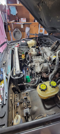

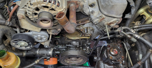

Digging in has begun with tearing down the front of the engine, I've been making notes of little oddities along the way.
For starters, I've been missing the windshield washer reservoir and pump since I bought it. This ride also came equipped with the ACE system, active cornering system; hence my double fluid reservoir there for the PSP/ACE. A previous owner deleted the ACE pump but left the lines in place.

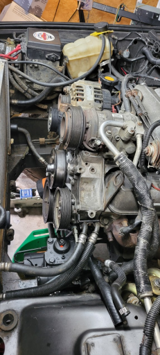

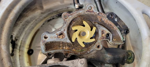

Getting a better look at the water pump, I've gotten the A/C compressor/PSP bracket removed here as well. More gunk in that top elbow than I'd like so it'll be swapped with Ron' and we'll refurb this one. Lots of oil gunk built up there due to the front main seal (now fixed, thanks Ron again) being ignored by the previous owner for much too long.

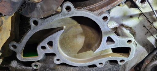

Water pump actually had a bad bearing. I couldn't identify the smoking gun for the coolant leak, but the entire bottom of the gasket area was saturated plus that bearing leaves me a couple areas of likely failure. When I spun the impeller I was glad I'm going through this, the bearing is pretty obviously coarse and near failure. Couldn't hear that one before...

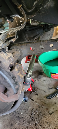

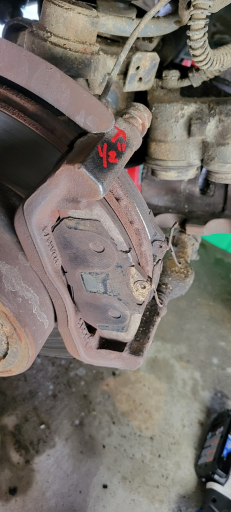

Day two, I dug in this morning looking at hub/brake replacement. First time having this apart so I'm learning as I go here. Turns out I'm missing a 3/4 12-point socket to remove the caliper bracket, one is on the way. Brakes are actually in decent shape but I have upgraded drilled/slotted rotors and will take the opportunity to freshen everything up regardless while replacing the hubs. I also needed to order the CV axle socket, I see these are a bear to get off so that should be fun when it arrives. With just the little bit of added access in removing the tire I can see I have a CV boot job ahead of me as well. It's 'ok' for now, but some fresh grease and boots or a full CV axle swap will be in order. I may try to limp this one along with a boot replacement since Ron and I plan to pull this differential and replace it with a locked unit sometime next year, we'll refurb my current one and keep it as a spare for the local Rovers.
I'm a big fan of paint markers, the second picture is something I typically do on my vehicles as I go through them. I take inventory of specific tools for specific jobs and when I complete a job I use this to build a tool-kit to keep on-board. If something breaks on a trip or out in the boonies frustrations will already be high, the added immediacy of having a known size to something is kind of handy and won't be seen when fully assembled. I've done this on certain points of my GS due to the fasteners BMW uses not being a standard I'm accustomed to.

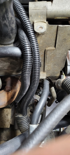

I mentioned finding oddities or small items to take care of, here's one. Frayed wires have been common due to most of the loom cracking and falling off. I'll be repairing this and working to cover as much of the exposed single jacket wires as I can. Other items are random bolts missing from support brackets. I found a seller on eBay to source four used (better shape) A/C & PSP bracket bolts as the heads on two of mine are rounded. I sent them a message about missing other odds and ends, he said he'd take a look, got back with me and said he'd throw all these others in with my initial order. Certainly appreciated and unexpected, I planned to pay for a special auction. I mention all this to give them a shoutout, if you're in the Rover landscape check them out - they took great care of me on a tiny order (OhioValleyRovers).
Water pump face cleaned and ready for the new pump.
Back to me missing tools, I took some time to access the PSP cooling loop line and steering gear. I hope to get the steering gear out tomorrow or this coming week. I have all new PSP lines that'll go in with the fresh PSP and steering gear. There were also a couple ACE lines that ran up near the PSP lines, I cut those back (you can barely see them in the center background). Ultimately I'll take more time to remove that system, but for now it gets them out of the way of my immediate work area.

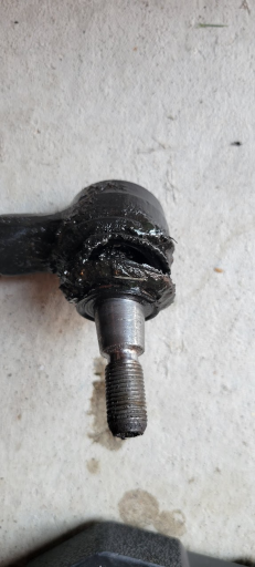

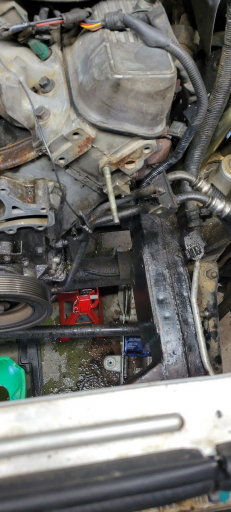

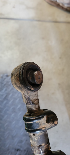

Reviewing back where I was in the prior post, we'll start with the steering gear removed. That was a 'fun' one man job.
Track and drag link joints were very worn out, if the boots weren't entirely missing they were at least fully open. The passenger track linkage was very loose, I ended up having to cut it out as I wasn't able to get enough leverage any other way to hold the ball in place while the impact did its work. Vice-grips just shredded the metal of the link. Below L/R is the driver side linkage and then the passenger side cut, lots of play in that joint.

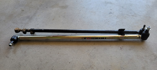

Old track bar vs new Terrafirma. Man is that an upgrade... holy smokes.

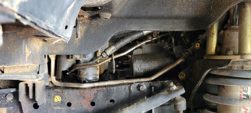

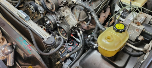

Power steering now fully plumbed.

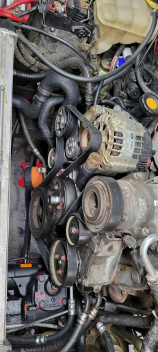

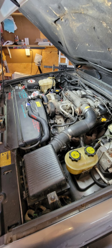

All new radiator hoses installed (man was that fun), idler pulleys reinstalled and belt back in. I didn't replace absolutely every coolant line, there's one behind the A/C compressor going to the reservoir which is in pretty good shape I'll monitor. It's been replaced already and didn't seem to warrant much attention. Note the split in the lower radiator hose where the factory thermostat would be.

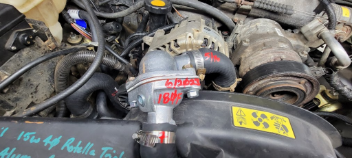

Annnnnd we're assembled! Note the thermostat up on the top-side there. I found a thermostat relocation kit which by all accounts, seems to be a very nice upgrade. Not only can I now source standard thermostats at any parts store, it's easier to service, change temps, reduced my temp to 180F and I now have an easy vent/monitoring port for future use. I plan to install a dedicated coolant temp sensor with dedicated gauge on the dash. OBD monitoring is neat and all, but I like redundancy on critical items. I'd love to figure out a true oil pressure monitor in the future as well...

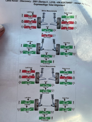

Even with needing an alignment, she drives MUCH better. Steering is lighter, predictable and obviously tighter. It'll really be much more enjoyable to drive as a daily and on trips now.
Next up we'll get an alignment done, balance the tires, seal up the six factory rack holes in the roof, patch the rust hole in the driver side floorboard and reassemble the interior.
View attachment 260275View attachment 260276
View attachment 260277View attachment 260278View attachment 260280
View attachment 260301View attachment 260302

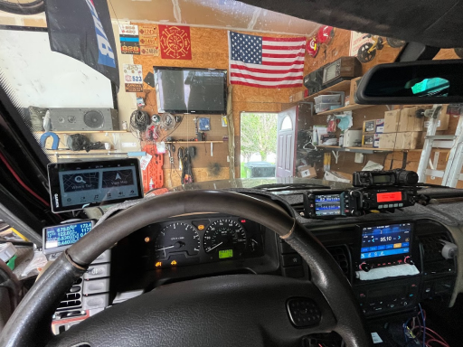

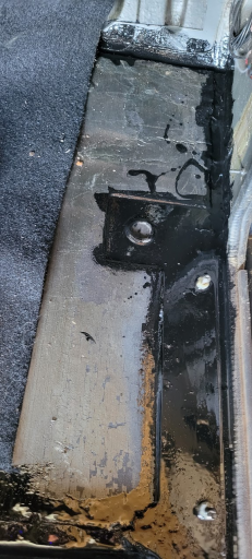

Spent some time today on the interior getting wiring ran so I could install carpet again. Part of the wiring gig was to situate my 'radio stack' and dash electronics. I'll run an FTM-400XDR as my go-to radio, XTL 2500 in VHF flavor pushing 110W off the roof for ultimate reach, the FT-857d head is velcro'ed as it won't live here, only used when working mobile HF activations such as Parks on the Air, Summits on the Air or any stationary HF work I might be in the mood for (emergencies being one). On the left I have the OBD scanner and mount for my shared Garmin ZUMO I also use on the F800. Missing is a phone mount which is on the way, dual camera 3.5" LCD to handle always-on front/rear cameras as needed, and a magnetic mount for my Uniden SDS100 scanner. Yep, I'm a radio nerd. Also added a custom carpet dash cover to help protect from UV and give me a hidden place to easily run wires.
Overview, of the view. Gotta say I'm not sold on the Garmin position... that may end up somewhere else if I find my sight line blocked off the driver side A pillar. We shall see. Other radios are all well below my sightline over the hood.
That's all for today!

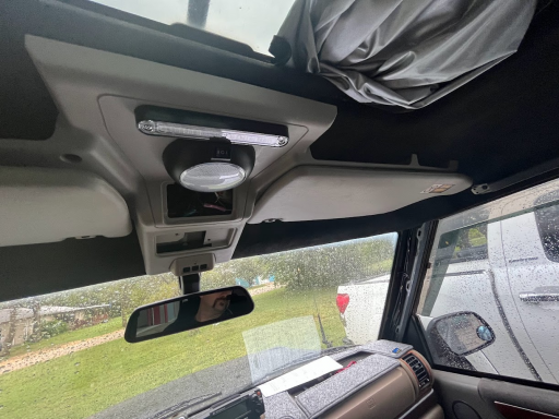

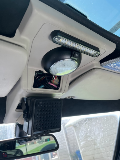

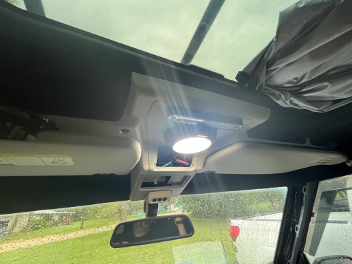

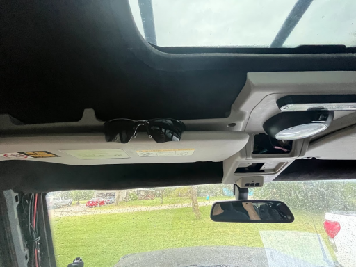

Progress lately has been interior focused, continuing the push to daily driving conveniences.
Thanks to a local recycler (CKARR, LLC in Whitewater, KS) I was able to snag a front overhead console, sun visors and grab handles that hadn't all been spray painted. With that portion refreshed, it's a bit more pleasant on the eyes. I've made contact with a gent named Mark in Colorado, he's parting out a Disco and will hopefully be sending me some parts. We shall see if that transpires.

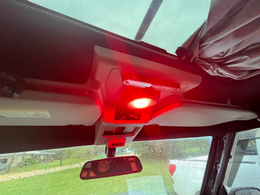

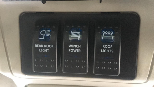

I was never impressed with the interior lighting on these, I like LOTS of light. I've replaced the factory with LED's that I mentioned in a previous post. The circular light is 'always hot' and can be used in white or red modes. Red will be handy for late night camping or HF POTA/SOTA work.
The longer slim light acts as factory dome, no more switch on the factory light itself to select the mode which I frankly prefer. In the old position of the dome light is now a speaker which I'll show a couple pictures later.
Here's a better look at my upgraded lighting, future home of some rocker switches and my larger speaker (runs off the FTM-400XDR). In the open section which used to house the sunroof controls will be a set of rocker switches. I intend to use these for lighting (I think), such as 'scene' or camp lighting, a chase light for dusty roads, etc.

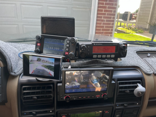

Pretty well finished up my wild dash stack. Bottom left is an always-on rear camera. With the spare tire mount, trying to watch mini-me in the back; I find the standard rear view mirror isn't super useful. Not to mention I want to be able to keep tabs on a trailer as I plan to tow the F800 behind this rig in the future. An el-cheapo headunit, which I think I posted about prior. Control heads for the FTM-400XDR on the left and a Motorola XTL2500 110W VHF, speaker in the back is for the XTL. I like nice crisp audio so the speaker is pretty prominent, it doesn't block my view up front despite what the picture may show. Not really pictured, but I did add four USB charging points. I use a magnetic charging mount for my phone just out of frame, it uses one of these. Three remaining are for whatever necessary, these are simple 12v to USB adapters hidden in the dash. I've also hardwired my Garmin GPS with a hidden power supply in the dash. I really like all my stuff hardwired and hidden as much as I can.
View attachment 262151View attachment 262152
View attachment 262153View attachment 262154
View attachment 262156View attachment 262157
