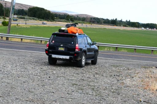

We strap our T4 Plus to the factory roof rack on our 2004 4Runner

I remember that picture ;-) I was about to ask you if you just throw it on the roof or do you have any kind of crossbars? What are you using to strap it with? This would solve my immediate needs... but I do want a more permanent solution long term.

I use ratchet straps to hold it down on the factory cross bars, then strap down my table and chairs... finally I have a bungee net that I use as a secondary system in case anything wiggles loose to give myself a few extra seconds to pull over in a whoops moment... not that I have ever had a whoops moment, but ya know... stuff happens.
like you we are looking for a roof rack, but until @KRose finds the one she loves that allows us to still use the sun roof we will keep using the cross bars.
