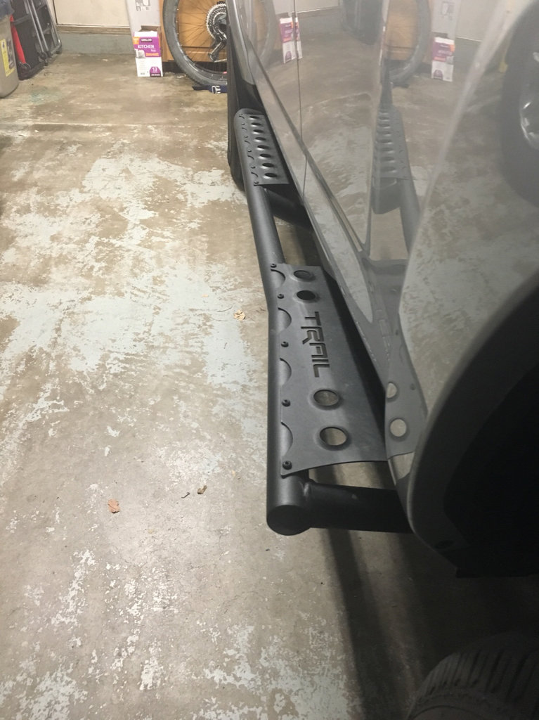

I took a picture today when changing my wheels from winters to all terrain. They have some salt but held up ok so far. I need some battle scars on these things, they are all still too new.
