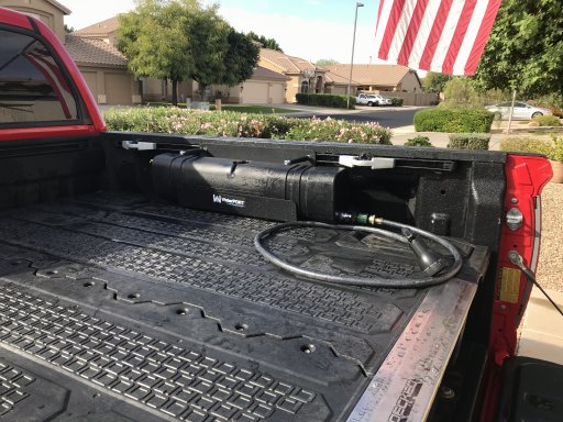

Recieved my Waterport on Friday and just installed it today. Very happy with it! Fits perfectly, especially with my Decked cargo drawers.
