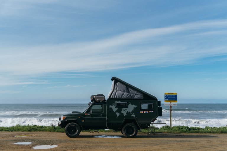

For sale is a 1991 Toyota Land Cruiser HDJ80 expedition camper built around Toyota 80 Series running gear, fitted with a 79 Series cab and a Maltec carbon fiber living cabin.
This is an HDJ80-based expedition camper with Maltec-built carbon fiber living quarters and Maltec-performed cab/cabin/frame integration. Maltec built the camper living space, integrated the 79 Series cab and carbon fiber cabin with the 80 Series platform, and extended the frame to accommodate the conversion.
The mechanical build was completed separately after import and includes a Toyota 1HDT crate engine, rebuilt H151F manual transmission, triple lockers, long-range fuel, custom suspension, Maltec carbon fiber living space, lithium power, solar, Webasto diesel heat, onboard air, water, refrigeration, and a compact camper interior.
The result is a rare, mechanically serious diesel Land Cruiser expedition camper built for long-distance travel. It is best suited for someone who understands diesel Land Cruisers, expedition conversions, and the difference between a branded camper/chassis conversion and a bolt-on overland build.
This is not a pavement-only collectible, a generic camper van, or a cosmetic overland build. It is a purpose-built expedition truck. Turn-key and ready to take you around the world.
The mileage displayed on the dash is not representative of the completed vehicle. The odometer belongs to the donor 79 Series interior that Maltec used when building the truck. It currently reads 290,222 km / 180,335 mi. Since the camper was assembled, the vehicle has approximately 35,000 miles of use, with most major engine and drivetrain components having approximately 29,000 miles.
