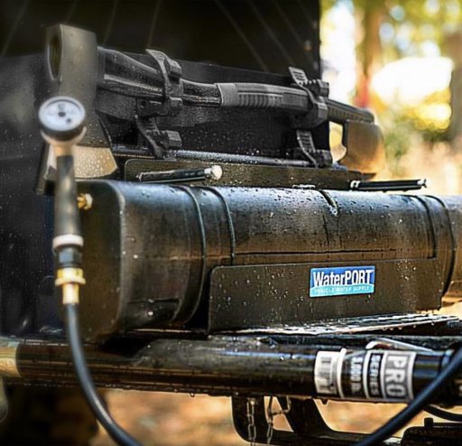

HI Guys,
Our new black tanks heat up in the sun. Depending on outside temperatures, you can see water temperature up in the High 80s. We also equipped our tanks for manual filling. Fill the tank either with fresh water or stream water and pressurize with a bike pump or compressor. Here is some customer photos. Ive also created a discount code "overlandbound" for 20% off for those wanting to try out the system. If you have any questions let me know!

HI Guys,
