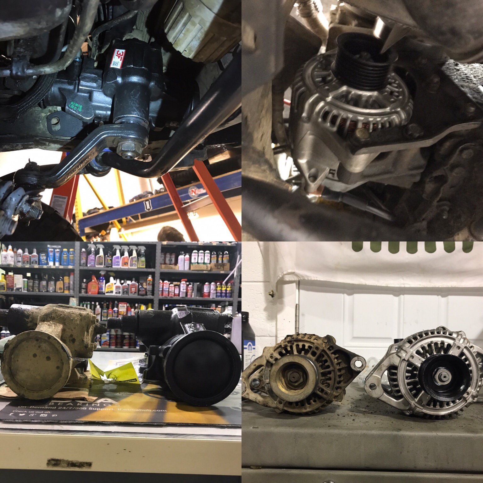

Upgraded to the 136amp alternator
Upsized all of my battery cable to 2 gauge
Dodge Durango power steering box swap
JCR power steering box spacer

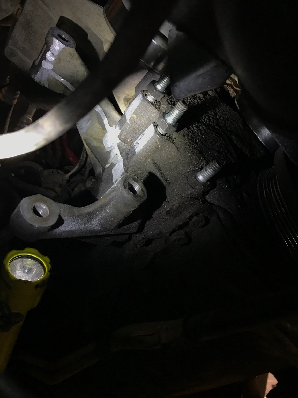

Replaced my power steering pump
Replaced my power steering lines
Replaced my tensioner pulley
New serpentine belt

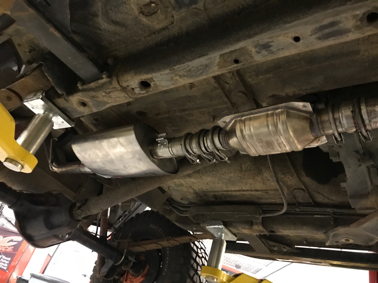

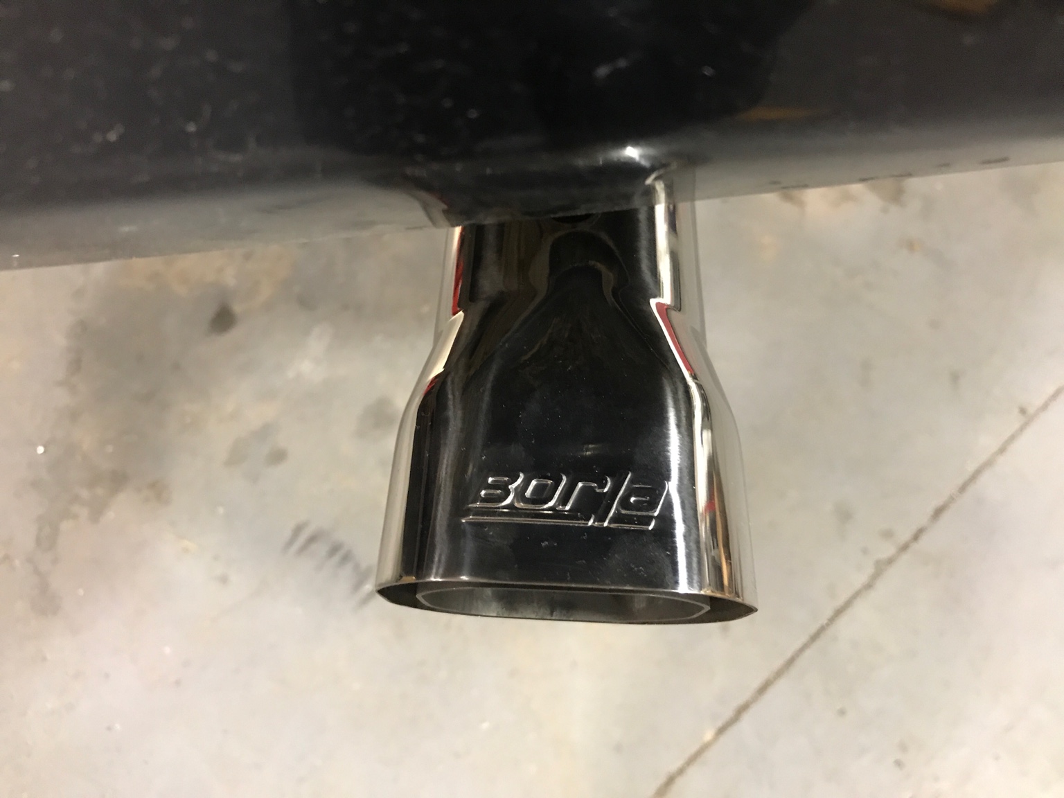

I also replaced my entire exhaust up to the manifold using the following components:
Walker Evans down pipe
Magnaflow high flow cat
Borla's cat back system
Everything went well except my power steering. After several attempts at bleeding the system I only had manual steering. Frustrated and tired from a weekend of work I drove the jeep home the way it was and figured I'd deal with it later in the week. The next morning when I went to drive the Jeep to work I noticed that I suddenly had some assist from my power steering, but it was very weak. I attempted to bleed it again but it made no noticeable difference. As of now I still only have a weak assist. I feel like the durulast pump I put in last minute is faulty, when I didn't have any assist I felt like I had no pressure in the power steering system.

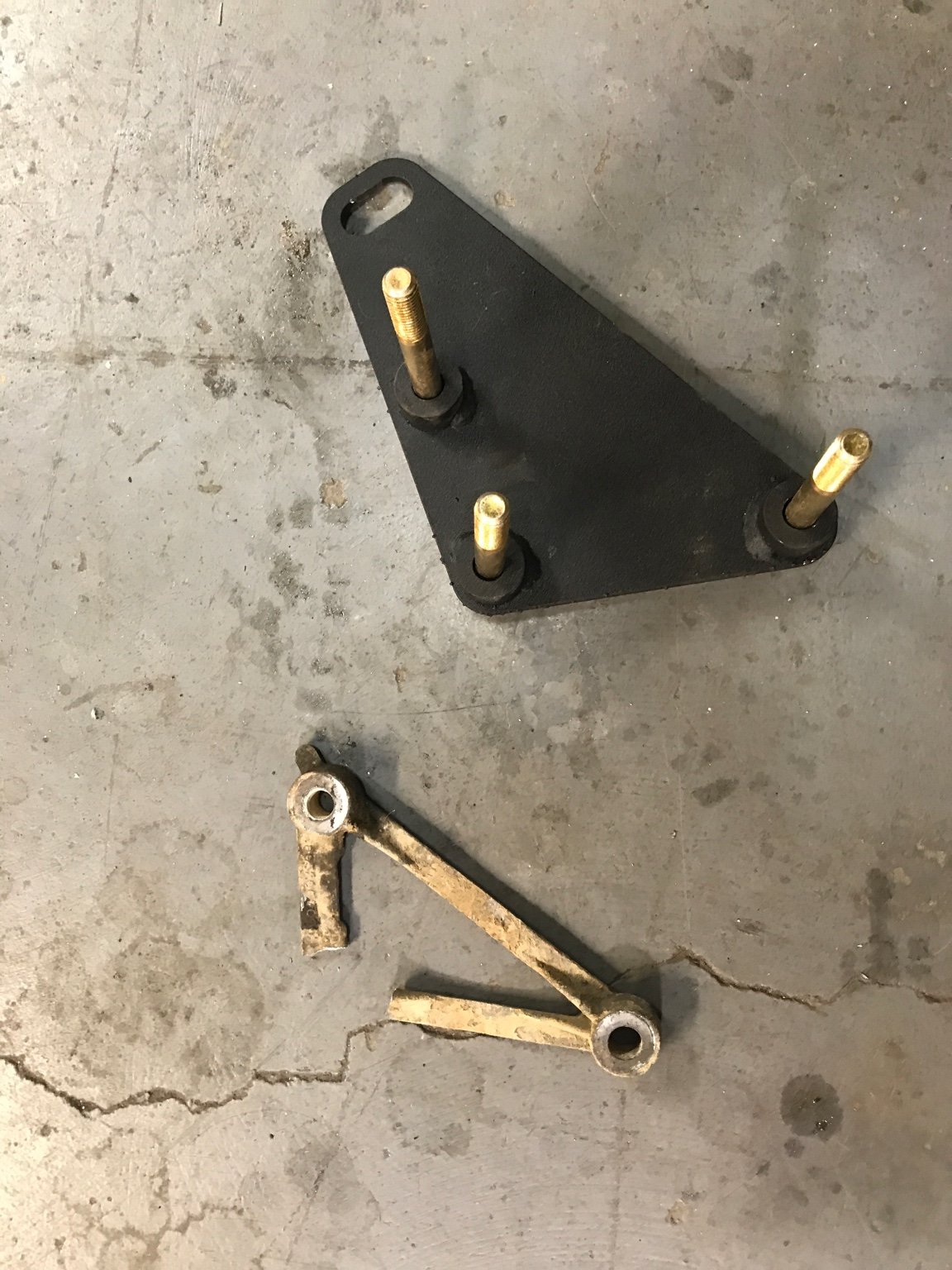

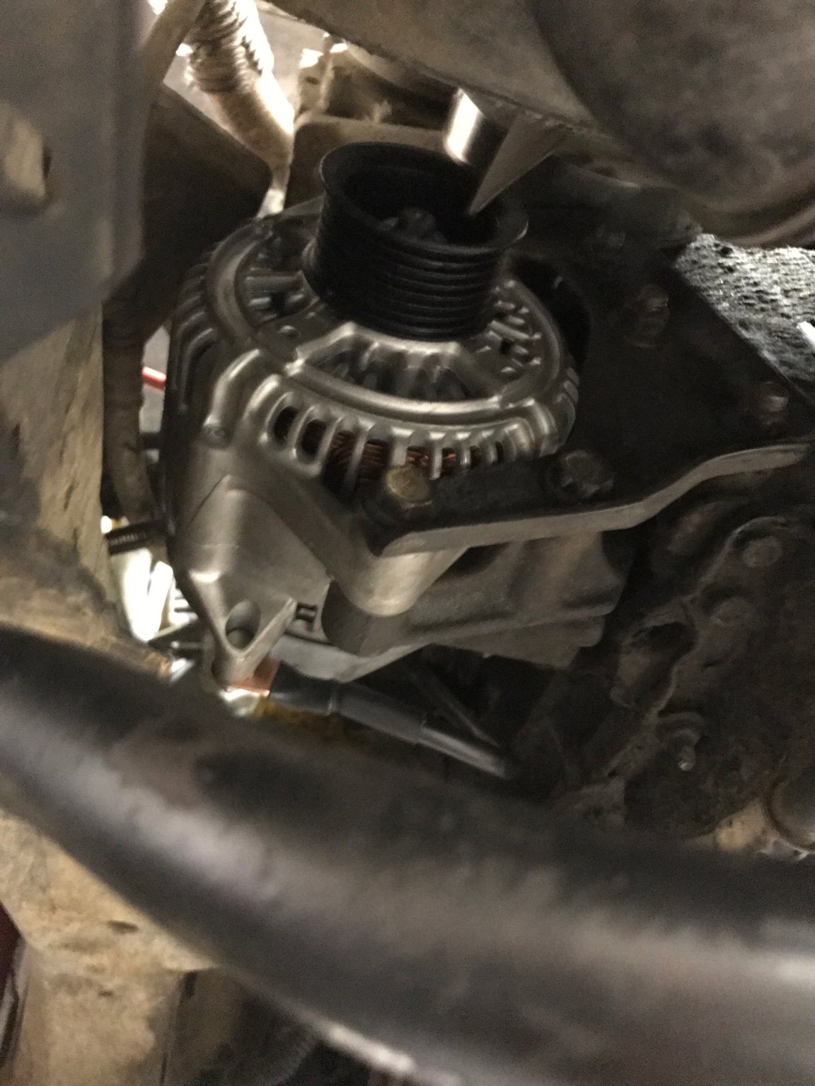

I haven't had any problems with my charging system in the past but when my current alternator started to become noisy I knew it was the perfect excuse to upgrade. I had recently added a 10lb warn winch, and plan on hard wiring my 2000w inverter in in the next month. I planned on swapping in a 136 amp alternator out of a V8 grand Cherokee. The swap was pretty straight forward.
I first removed the current alternator and the bracket. I assembled the two piece bracket off the jeep and attempted to fit it to the new larger bodied 136 amp alternator. There were some obvious clearance issues and I had to grind the bracket to be slightly deeper to fit the alternator. After I was able to fit the bracket I remounted it to the motor and noticed that the motor also had to be clearanced
After that the alternator bolted right up

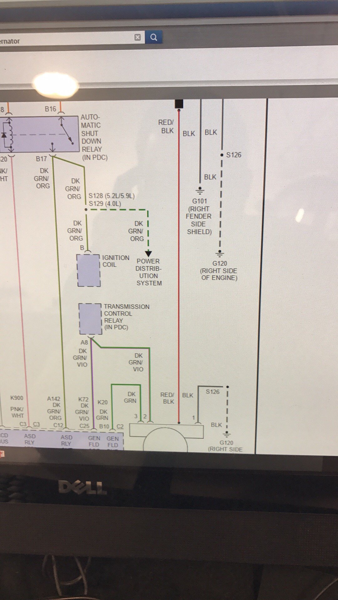

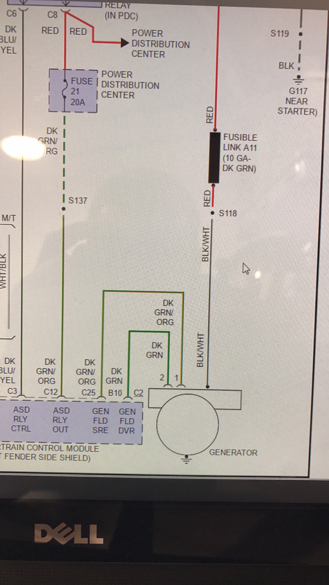

After that came the wiring. Previously on my 99 Cherokee there was a two wire harness that plugged into the back of the stock alternator to what I am assuming is the regulator, on the new one there was a place for two ring terminals. After a check of the wiring schematics:
Cherokee:
A grand Cherokee that runs the alternator that I am swapping in:
It appeared I simply needed to remove the harness, and replace with ring terminals and wire them to the right place. (Sorry for the lack of detail, follow the diagrams!) I also noticed the new alternator had it's own ground. So to make sure it functioned properly I added one!

The exhaust went well, it was a necessary for me to redo it because my previous one was smashed against my floor and was causing issues.

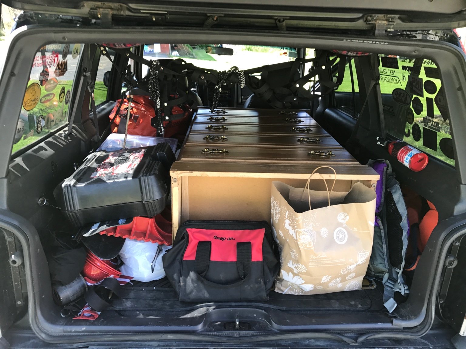

Weighed my jeep yesterday.
Unloaded
4180
Loaded with people only
4560
Not sure what the max capacity is of the jeep but I'm much heavy over stock and that doesn't include any of my gear! I need to loose some weight!

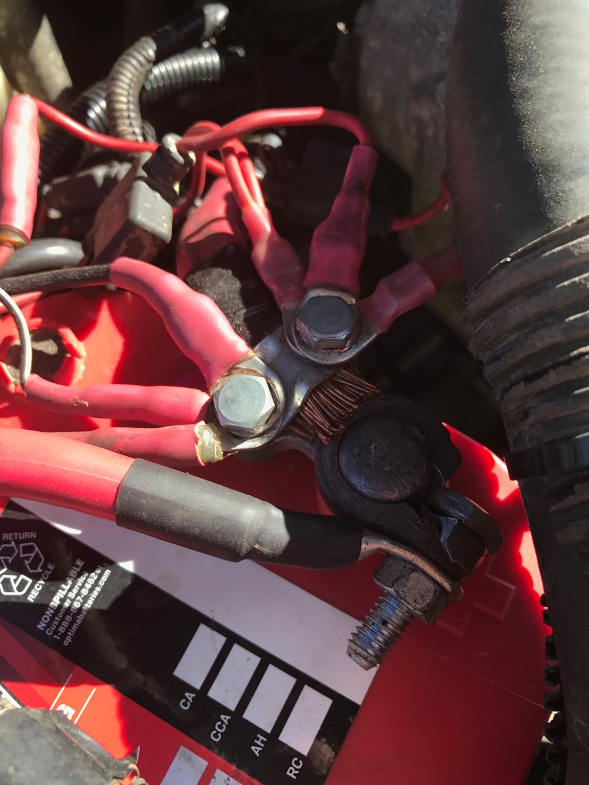

All in all things went well. I need to rotate and balance my tires, change my oil and take another look at my power steering issue before the tip. I also discovered that my positive terminal ring has sheered off so I will need to replace that as well!

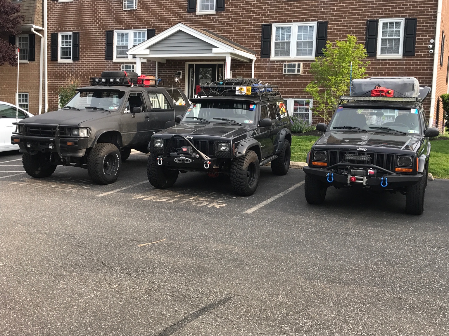

After months of planning my brother, best friend, my girlfriend and I met up at my apartment in West Chester, Pa in our three rigs.
My friend Aaron (Member: 2704, Screen Name: Yota_4runner86), drives a 1986 Toyota 4runner with a 4" lift and 32" KO2's. Originally it came with the 22RE but the previous owner for some reason swapped in a supposed stroker 22R (which is carbonated compared to the original fuel injected motor). He's put a ton of work into it for this trip rebuilding most of his suspension and front hubs. For sleeping arrangements he built a single bed inside the back of his spacious yota.
My brother Greg (Member: 2758 Screen Name: Greg Galbo) has a 1997 Jeep Cherokee with the 4.0L, 2" lift and 29" tall tires (not sure what the metric size is). He gets to sleep in a new Tepui tent that he purchased right before the trip giving him the best sleeping quarters of all of us!
Me (Member: 2759 Screen Name: Jason Galbo) and my girlfriend shared a backpacking tent which we carried around in my 1999 Jeep Cherokee (read the rest of the thread for my build)
