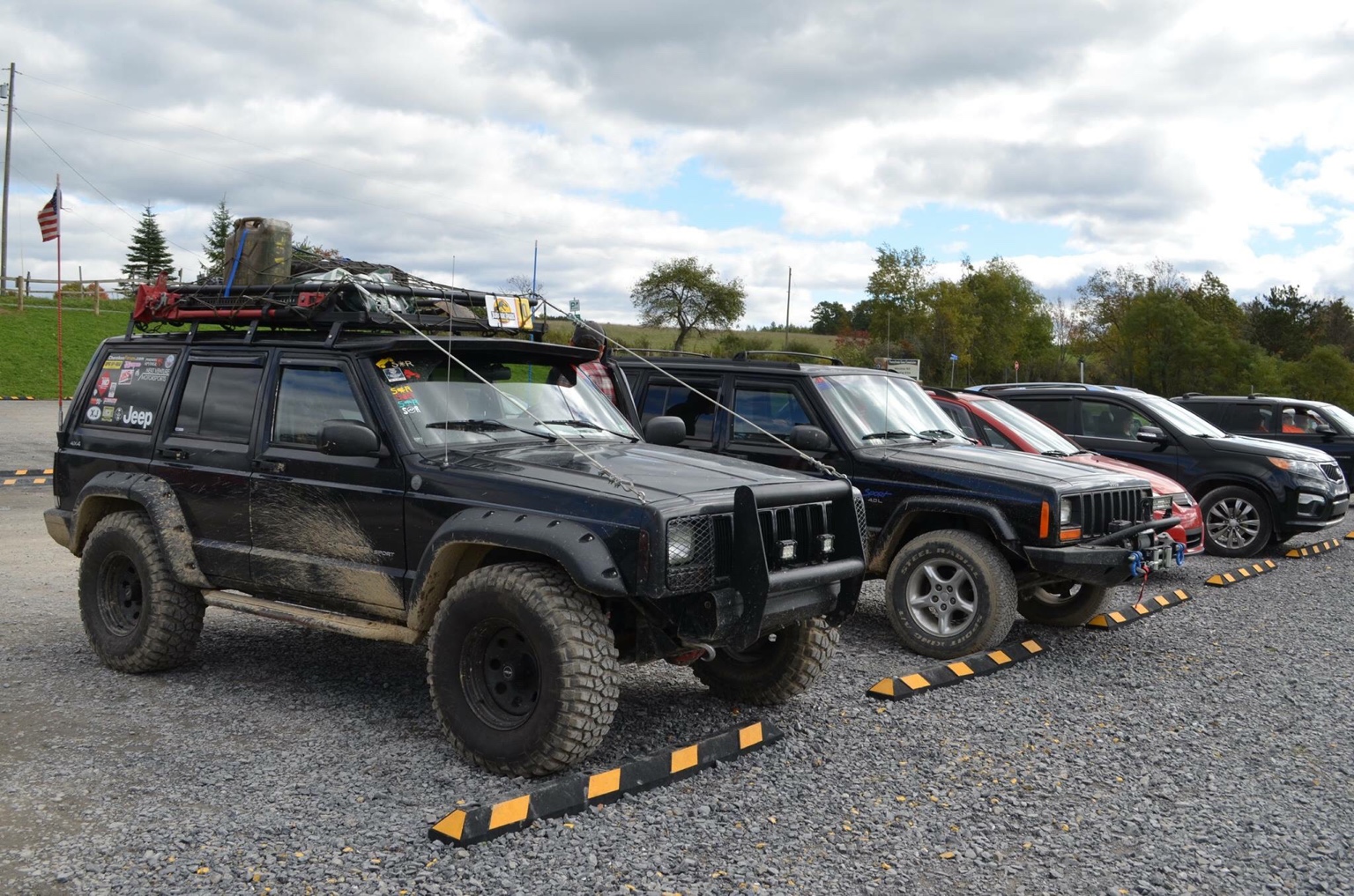

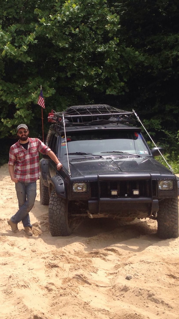

Hey everyone! My names Jason and this is my 1999 Jeep Herokee! My build is about four years in the making now so you're going to have to hang with me while I try to recap everything I've done while keeping up with everything I am doing! But before we get into it let's start with what I have.
1999 Jeep Cherokee
195,000mls and counting!
Motor:
4.0L
Transmission:
AW4
Transfer case:
NP231
Suspension:
2" lift
Front axle:
High pinion D30 with 3.55's
Rear axle:

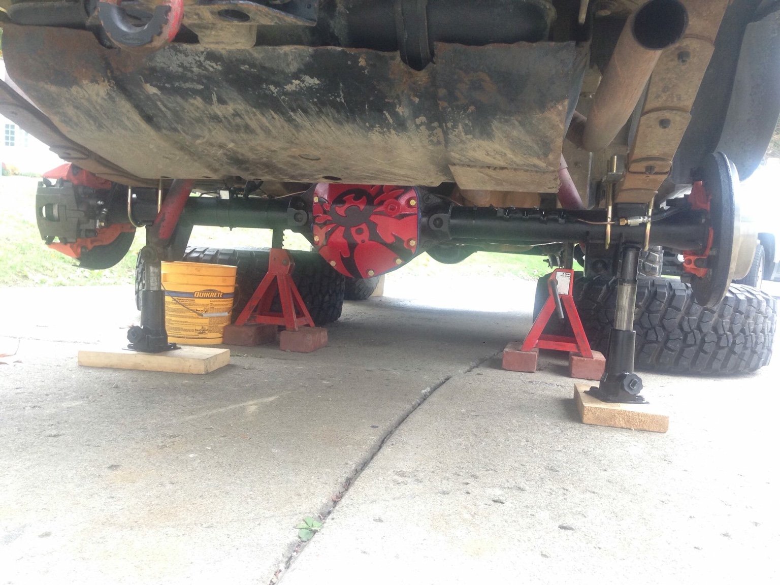

XJ D44 with a factory LSD and 3.55's and a disc brake swap
(Originally had a D35)
Tires:
32" BFG KM2's
Current modifications include:
1. Lund sun-visor
2. Transmission cooler
3. LED interior light conversion
4. LED license plate light conversion

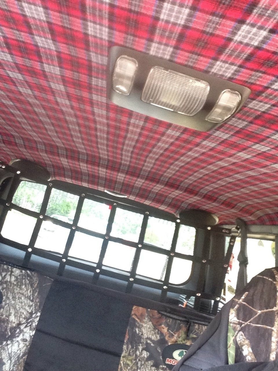

5. Red plaid headliner
6. Cree LED pods
7. Bushwacker Fender Flares (pocket style)
8.Poison Spyder Diff Covers (front and rear)
9. Swapped in a factory XJ Dana 44
10. ABS delete (necessary for rear axle swap)
11. Rear disc brake conversion (92 Crown Vic)
12. Accel ignition system
13. Optima Redtop Battery
14. K&N air filter
15. Factory bumper chop (stubby for clearance)
16. Next Venture Rock Sliders w/ aluminum step sides
17. Hitch mounted D-ring tab
18. 2" Fat Bob's Garage coil spacers
19. JKS Quick Disconnects
20. Rear Dodge Durango Leaf packs with XJ main
21. JK sport shocks
22. Magna flow high flow cat
23. Borla Cat Back System
24. Factory XJ front steering skid
25. Factory XJ TCase skid
26. Factory XJ gas tank skid
27. Mag light and mount by drivers footwell
28. Midland CB radio and Firestick Antenna
29. Rear dual USB port/volt meter/12v port
30. Rear mounted fire extinguisher
31. Med kit mounted on my rear drivers door
32. Emergency Hammer mounted on center counsel door
33. 15" steel wheels
34. Roof rack
35. Roof rack mounted Reese Jack
36. Roof rack mounted full size spare
37. Bull bar from a fs chevy
38. PA system
39. Headlight guards
40. Limb risers
41. Paracord grab handles
42. Factory XJ tow hooks and brackets
43. V8 ZJ tie rod conversion
44. Electric fan control (works like factory but can be switched to Manual on/off control)
45. Trailhawk badge
46. Trail Tuff Nets cargo Net
47. Gobi Ladder
48. Factory Jeep* rain visors
49. Brown Dog Motor Mounts
50. Alternator Splash Guard
51. JCR Mauler Bumper
52. Warn 10lbs synthetic line winch
53. Factor55 LLC. Extreme Flat Link
54. 136amp alternator upgrade
55. Battery cable upsized
56. Dodge Durango box swap
57. JCR power steering box spacer
I'm sure I'm forgetting some things but that's the bulk of it.

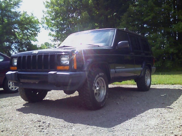

I have some time so I'll start by telling you a little about myself. Four years ago I was driving my dad's old four door ford focus station-wagon. I was working in a local cheese shredding plant making some decent money and with my younger brother coming up on 16 I knew it was time for me to get my own vehicle. During the time that I was fortunate to be borrowing my dad's second car I had worked hard and saved enough cash to get something of my own. I knew I wanted a four wheel drive vehicle. All my friends had one and because I lived in a rural area I wanted one to keep up with them when they went off the paved path! So enters a mostly stock 1999 Jeep Cherokee! By the small scratches down the side and the small stock sized mud tires I could tell that someone had previously had this off road but it had no rust, ran great, cost only 3 grand, had just 131,000 miles! I was in love! At the time I didn't have any experience with mechanical work but early on I decided that I wouldn't take my jeep to the shop unless it was something "serious." I started with basic maintenance, things like oil changes, brakes and spark plugs became easy, I soon became capable of doing slightly more advanced things like wheel hubs. Eventually I started doing small modifications. After awhile I decided that this is what I wanted to do with my life. I quit my job, took the money I had saved and went to school for automotive technology. Now, a few years after I graduated I've got a job with a company professionally outfitting four wheel drive vehicles for overland travel! I'm obsessed, I work it, I day dream about it, and above all else I live it! I am more of an off-roader but recently I started getting into overland and it has inspired several more modifications to my jeep! But this is a build thread not a bio! So I'll end this rant with a photo and hopefully the next post will be about my modifications . If you want to know about any of the mods I listed in detail please ask and I'll take pictures and post photos or give reviews! Just let me know!
(Pouring over a map on the hood of my brothers jeep at the last gas station before we left society, we tried to pick our landing spot for the night! From left to right: fellow adventurers Aaron Milz, myself, my brother Greg Galbo and his Girlfriend Kayla, taking the photo and always by my side is another fellow adventure and my girlfriend Carrie)
