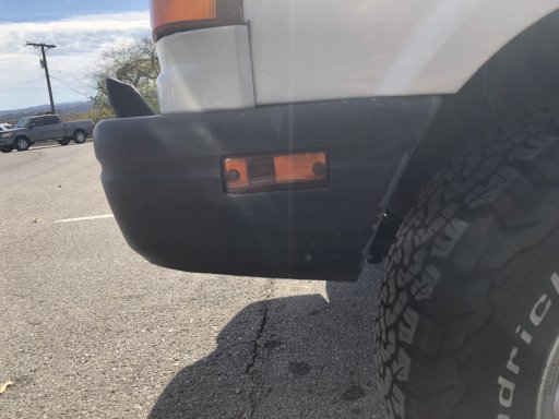

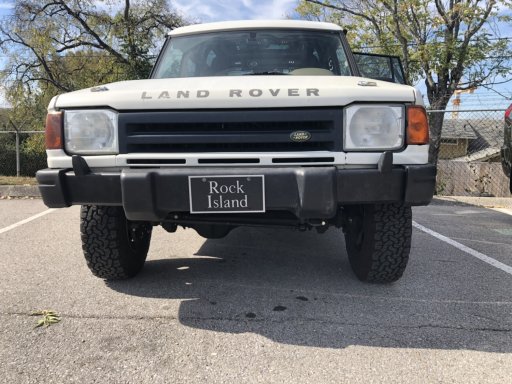

Really need to see a close up of your front bumper cropping please. The center section is giving me fits on what and where to cut it down.
What is an alpine window seal ?
“Alpine windows” are what the upper windows tucked in the corners are referred to typically. At least in 21/23 window busses.(only other vehicles if had with them)
I’ll get you a front bumper pic in the daylight tomorrow.
The center of my bumper unbolted, the lower half was all plastic, all I cut were the side pieces. Though I imagine the D2 bumper may be slightly different.

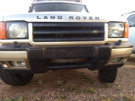

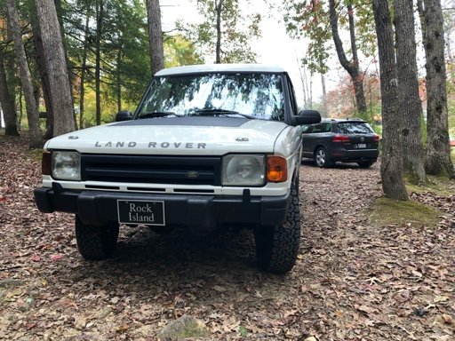

This is what my front bumper looks like. I'm wanting to cut it just above the fog lites which looks to be about where you cut yours. If I can't cut it I'm just going to remove the whole bumper.
Wow, IT'S HARD TO BELIEVE THERE IS THAT MUCH DIFFERENCE BETWEEN the LRD! and LRD2 frontal area. Just looking I thought they were closer. Looks like I will not be able to whack off my lower skirt so easily as you if at all. Must find a solution before I can put the new tires on.
Yep, the D1 has a steel bumper, and all the other bits are bolted or clipped to it to make it more aerodynamic\beautiful lol. Take off the spoiler, and trim the end caps and you’re left with a reasonably useful off road bumper.

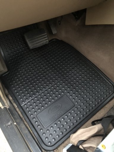

Today my floor mats showed up, not much work, and Land Rover is certainly proud of them but I’m fairly certain the first set “lasted” 160k miles so these should last at least that long.
Before-
After-
