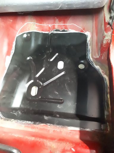

You can do one of two things JAMES, You can buy patch panels for jeep floors (easier to cut out big sections) and flux weld in new panels, OR you can leave the holes so your passenger can stick his foot in the hole for extra stopping power. :-)
Just finished putting new floors in it on the weekend ... Apparently I don't have a finished product picture... I was probly too interested in grabbing a beer for a good days work done lol

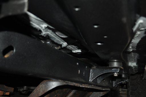

Me too! I just had to do half of the driver's side footwell AND the torque box (full length) beneath it in my LJ. The previous owner used basic flat floor mats and not Husky liners (for example) which pool the winter slush & snow instead of allowing it to soak into the carpets where it never dries out. The rest of the floor boards and the passenger side torque box were all good.
Very few pics here too. It's such a pain in the butt job (especially the torque box) that I wasn't in the mood. Definitely needed a beer … or two.

I was lucky and my torque boxes were still in really good shape but both pans were pooched. once the seam sealer cures I need to figure out if the carpet is going back in or not. I am planning on doing some sound deadening in it for the wife and may spray bed liner over it but I think the carpet may still be needed .... we will see.
Excellent, should do for another 20 years. Yup, beers will do it, ha ha ha.
View attachment 144827View attachment 144828
Good job !!
You didn't weld them ? How good is seam sealer ?
NOt a Wrangler but I ran no carpet/padding in a previous XJ of mine for about a week then put it back in as fast as I could. It was miserably hot and loud.
ya thats pretty much what I was thinking. its loud to begin with at the moment because it doesn't really have an exhaust and I know the transmission tunnel gets hot enough to cook on LOL.

Good job !!
Thanks. I've done similar work on many uni-body vehicles but other than some British cars that are easy to remove the body from, this is the first time I've worked on one like this with a frame. It was a pain in the butt because, to replace a torque box without having the body totally off of the frame, you have to remove 6 of the 11 body/frame bolts, tilt the body up on the side to be replaced by about 4" and snake in the new torque box. Of course it never fits on the first try so you have to do it several times. You leave the remaining bolts on the opposite side in so the body doesn't shift on the frame while it's tilted. The whole job requires a lot of swearing and as mentioned, beer when you're done, if you can wait that long.
