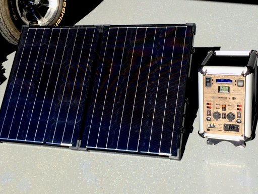

There is one more company in the US that makes great power product’s. You might want to look at their options. I have gotten three of theirs units.
( one kilowatt unit Adjustments.JPG one self contained Ham radio unit 7EB96DB8-CEC3-4BF8-9BF5-D129B9FB5DEA-298-000000172F41C096.JPG and a small but powerful battery pack. All will drive multiple functions plus all are rechargeable with just a Solar panel if needed. The name of the Tennessee company is Harden Power Systems Hardened Power Systems, USA – INNOVATION THAT WORKS. HARD.. Just call they will tell you about their units and driving a CPAP. They are helpful and will talk your ear off. Great to do business with.
Have a great day, and enjoy that sleep!
Tug

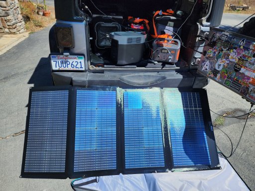

I run my cpap with a Jackery or 12v marine battery that is mounted in the box on my M416 trailer. I recharge them via solar or plugged into the XJ while traveling the next day. The marine battery runs the Dream station with the humidifier for two nights without charging. Look online for a 12v power cord for your cpap. it's very possible that the manufacturer of your cpap offers a 12v cord.

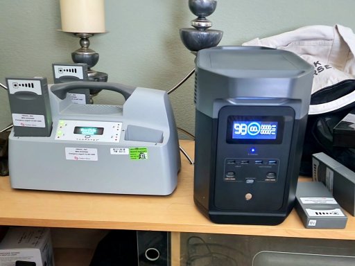

I highly suggest ecoflow. Depending on how long you stay and how many watts your CPAP consumes, they have a bunch of battery sizes.
I use a delta 2 (1024wh) for my heart pump. It was critical that my pump was powered at all times (either battery or direct power).
Also brought a 220 watt solar panel.
