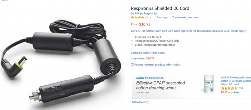

All the cpap's I have had over the last 20 years had a 12v input and I only had to fab or buy a cord to connect it to the battery (cig lighter)
Note: running the humidifier on most will limit you to the inverter route and radically up you power draw. I find the humidifier isn't usually needed because you are sleeping in a confined space and the humidity naturally increases.

Quite literally picked up mu CPAP yesterday! Did a quick google for "12v cpap" and came up with this option.
Cpap 12v adapter kit.
So I may be investing in a portable battery set up soon.
