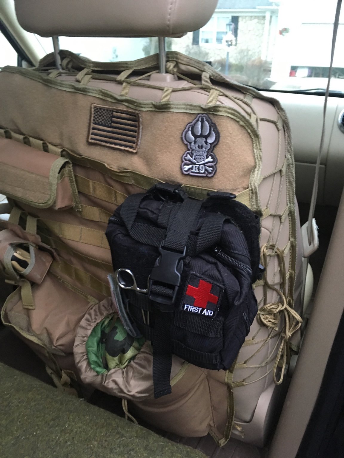

For myself I actually have three different kits. The first one is velcroed to the back of my headrest in my truck and has the basics to address potential car accidents.

I keep a First Aid kit on both sides behind the head rest of the back seat and a Trauma kit under the back seat driver side, plus two fire extinguishers.
