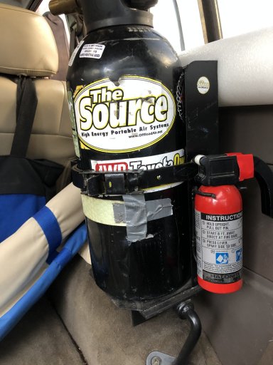

This works for me, I’m able to run my hose to all tires via rear sliding windows. Only issue is “The Man” always coming up with some new test to sell you a new valve. Other than that. I had the mounting bracket welded to my unused 3rd row seat bracket just need to make sure the hose is ALWAYS on board,Doh!
