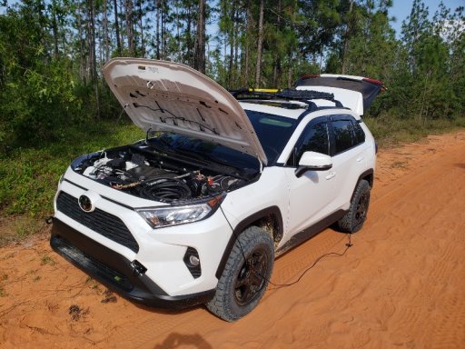

I had on-board air in my 4Runner, and hated not having it in my new Rav4. It seemed like at least once a week I am reinflating my rig's tires, topping off bike tires at the trail, or inflating pool toys. Not to mention rattling off lug nuts with my impact wrench. Hauling my compressor out each time was just a hassle after experiencing a permanent high-flow air source.
So, I took my Puma's compressor off the tank and stuffed it under the hood! Much better.

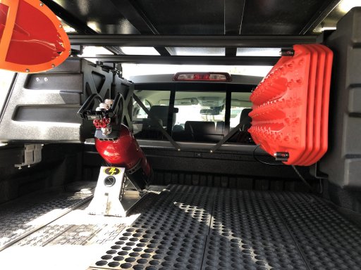

I carrier a small 5lb tank on my Can Am X3, love it. I want to carry a second 10-15 lb Power tank on my truck. They are very handy for tires, and air tools.

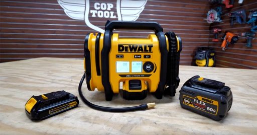

Most of the major tool brands make a version of this. Dewalt makes one that you set the psi you want and leave it. It will auto shut off once it gets to thr psi you inputted. It also runs on their popular 20v batteries. Considering I have thousands of dollars already set up with Dewalt tools I'm going to get one.
They also have power inverters that run off their batteries. I would say they are game changers esp for people that already have the batteries dewalt.jpeg
