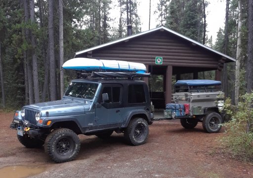

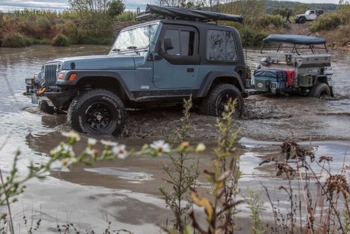

Don't knock the little Northern Tool or HF-type 4' trailer frames when building an overlanding trailer. I've got thousands of miles on this little HF-based trailer doing some crazy stuff. It is amazing how much stuff you can put into (and on) one of these little trailers.
Properly modified (not too difficult) they're quite robust. Here's a long (very long) thread, but lots of good info. Once you get though reading it, you'll be like "I can build one of those".
