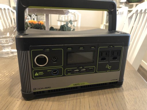

I know this topic is nearly a month old now, but I just received my 500x from REI. I ordered it with the 20% off coupon so I could run my CPAP. It did an amazing job on my first test. I used a pump to both inflate and deflate two queen-sized air mattresses from AC and it was still at 99%. I then used it overnight with my CPAP from 12V with both heated hose and humidifier at its regular setting and in the morning I still had 65% battery left. This means without any extra charging I can easily run a camp for two nights. If I take the heated hose and humidifier out of the equation I'm sure I could extend that to four nights (and with a solar panel on it that can probably be extended significantly due to the reduced total draw). I will be trying a test without humidifier soon.
Really love the overall package. It is quite compact and light. REALLY love the 60W USB-C power delivery option for computers, phones, and any future accessories that can utilize USB-C.

The wife and I decided to do a trail on a local mountain and have a quick lunch. Decided to test out the Dometic with the 500x and noticed an issue.
When I got to the lunch spot, I went to the back and noticed the fridge was off. When I looked at the 12v plug, it looks like it backed out enough to turn off. I thought maybe I didn’t plug it deep enough and inserted it again.
At the end of the day back home, I was unloading it again and noticed the same thing happened.
I’m going back out and going to do a test with another one of my 12v accessories to see if it’s Dometic’s 12v plug being too skinny or the 500x plug being slightly large. Did a quick test at home and the dometic 12v does seem a bit smaller compared to others.
Anyone see this issue? Worse case, I may plug my fridge directly to the truck and when I get to the site plug it into the battery, but that’s a hassle.
I don’t have a 12V fridge so maybe my input is useless, but I did test my 500X with my CPAP using 12V and it fit snuggly (had to use a moderate amount of force to remove). I suspect the Dometic plug is a bit thin as you suggested. Think you can wrap a few layers of electrical tape where it rests against the edge of the plug to try and get it to sit a bit better?

I just checked the 12v adapter from my Dometic CFX3 with my Goal Zero Yeti 500x. It's nice and snug and does not remove overly easily. You might be able to adjust the spring tension on the sides of the adapter. Or have Dometic send you another adapter.

I have a Flexopower 444 and I too had issues with my fridge plug coming loose. I had a cigarette lighter plug to Anderson connector that fit in the Flexopower's 12V cigarette receptacle more securely so I cut the cigarette plug off the fridge and wired it to an Anderson connector and now it holds secure through the Anderson connector to cigarette lighter adapter without coming loose. 12V cigarette lighter plugs are the most unreliable 12V receptacle made IMO, I can't believe after all these years they haven't improved on it.

As a suggestion, change your power cords to Anderson power poles. We have always used Anderson’s for our radios (ham and CB) so when we went to a fridge changing it to Anderson connectors was automatic. We will be setting up solar and a power station also and again, Anderson will be the setup.
