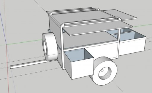

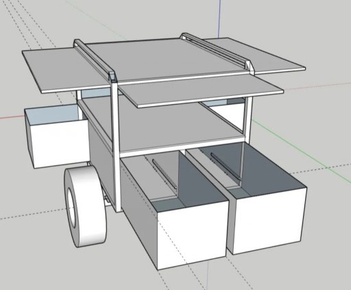

So I have been planning different aspects of this build for a fairly long time and have finally started building it.
I started out by making some drawings up to get an idea of materials used and a rough finished weight ( guesstimation before getting to far in and realizing it's way too heavy lol).
I keep going through the drawings and finding little things to change here and there that have clearance issues or material changes, but I think I have it all worked out and decided to start. Basically my drawings are rough and are not the final product.
The rear will have 2 slide out platforms ( not drawers) that will run a 48" locking drawer slide, the sides I may turn into 1 more 48" slide as well but am also considering just leaving it as an open compartment.
The top half will be a large open compartment accessible from all sides for storing larger gear like tents, Jack's, traction aids, shovels, etc.
I also planed a roof rack for the top so I can haul kayaks, mount an awning, as we as my camp shower.... and in the future may also add a RTT up there... we will see.
I have decided to try my hand at building and independent suspension system ( which the drawing shows very poorly because the drawings weren't really for designing suspension in my mind). So ha have a bit more planning to do around that.
The structure of the main base of the trailer may be a bit overkill but in my mind it shouldn't bent or twist causing issues later on down the road.... time will tell.

The base of the trailer is made of 2x2x.125 square tube. It is a 4x6 outer dimension so that it could be skinned using standard 4x8 sheets of material trimmed out with the least amount of waste.
The tongue is 2.5x2.5x.238 hitch tube with should add even more rigidity in the long run and allow for a hitch mounting point at the rear as well as a removable receiver.
So far the tongue is just set in place. I need to figure out much it's going to stick out the back.
