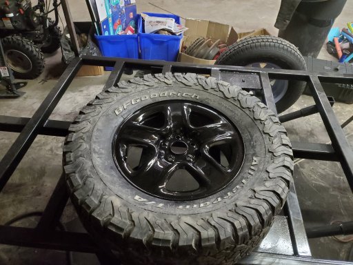

I forgot how much I hated manually changing tires lol. I only got 2 33s when I grabbed the other set of tires to use the rims because they were super cheap. They are fairly worn but it gives me an idea of how the trailer will sit and I can start to plan out my fenders ( also why i dismounted and mounted manually because I bought everything cheaper than I could have them changed over for).
I grabbed se more material for the roof structure and upper deck and can start working on those as well, but I would like to get the fenders sorted out so I can figure out a tail light situation.
It's slowly coming together and I am hoping to be able to actually use it this year.

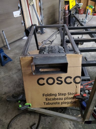

A bit more progress tonight. Got the shape of some fenders mocked up.

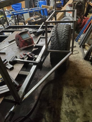

Final fender shape layed out. A brace in the middle and think I can get a skin on them and get my tail lights mounted up. I gotta shift my attention back to the interior and get the drawer slides made up so that I can get the final dimensions of the inside solidified.

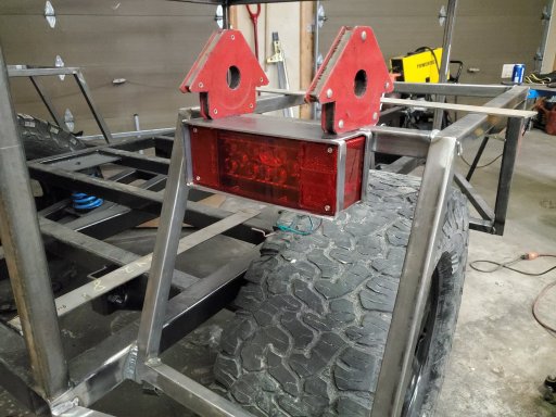

Gotnout into the garage for a bit today and welded up some taillight boxes that I will incorporate into the fenders

Gonna have to get me some of those zip tie tabs. I'm building one too and want to route wires outside of the frame this time. Ran them inside the frame last time but I want this one completely water sealed.

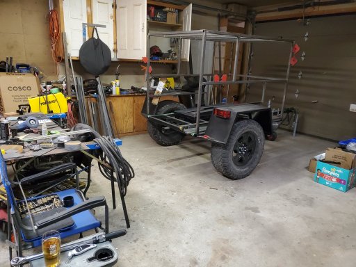

Drawer slides tacked, doors " framed", fenders done, roof rails tacked in, and 1 stabilizer made up to see where/how I want to mount them ( not where it is in the picture they will mount under the floor of the trailer and swing down).... small progress on a few of the things on the list lol.
Looks kind tall to me. Are you planning on putting a tent on the rack? Depending on the weight down low, it may be a bit top heavy. Just an observation.
Looking good so far though!
