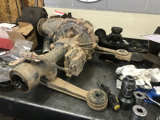

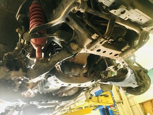

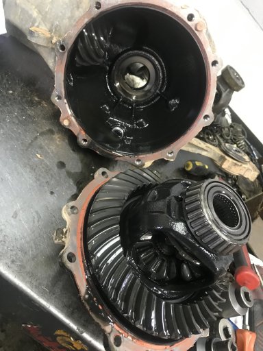

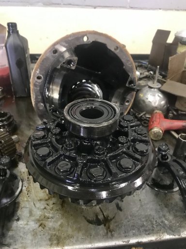

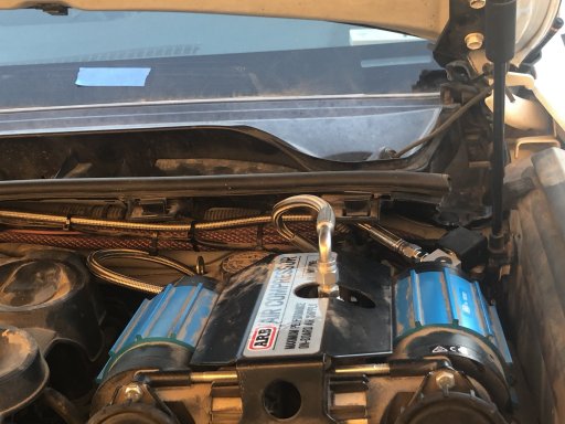

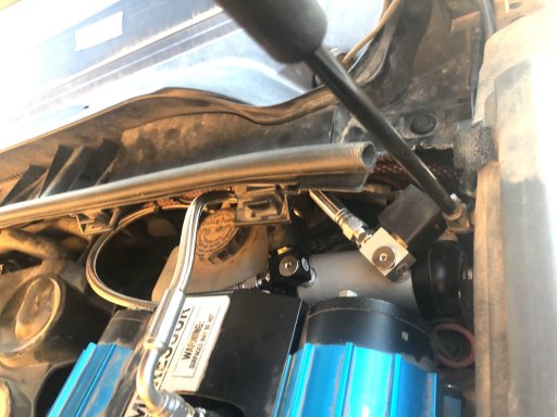

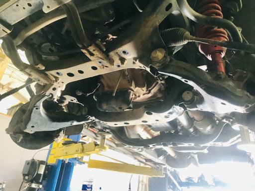

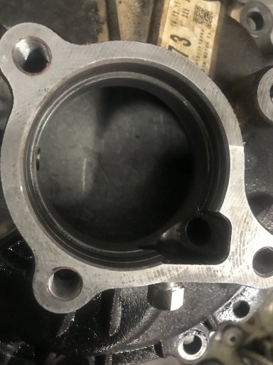

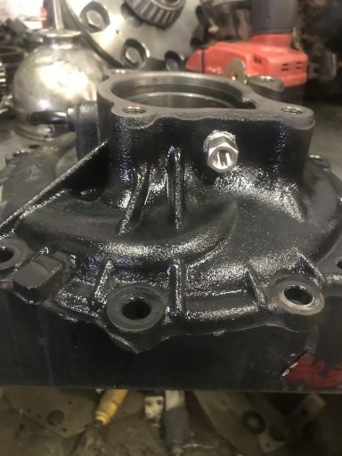

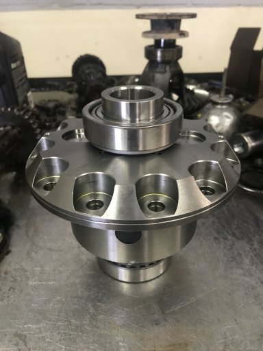

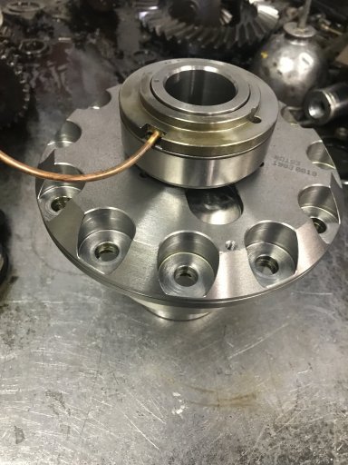

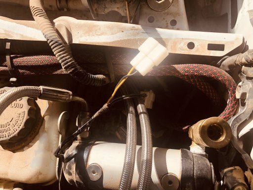

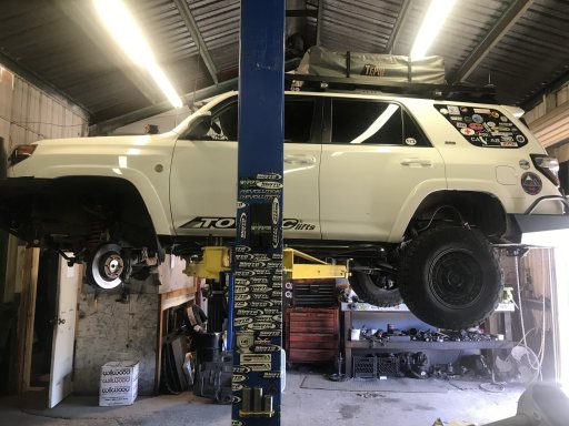

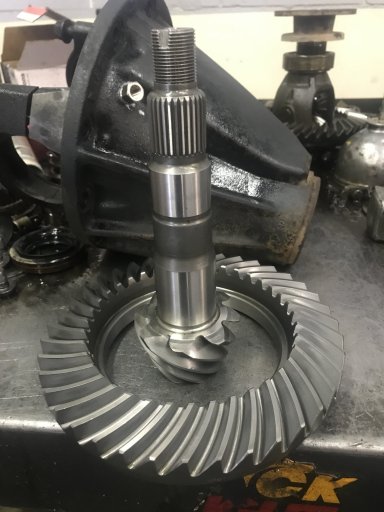

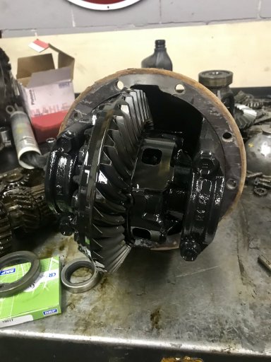

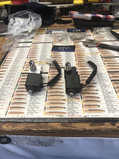

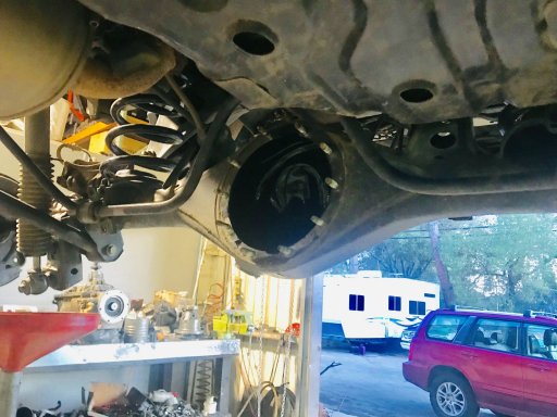

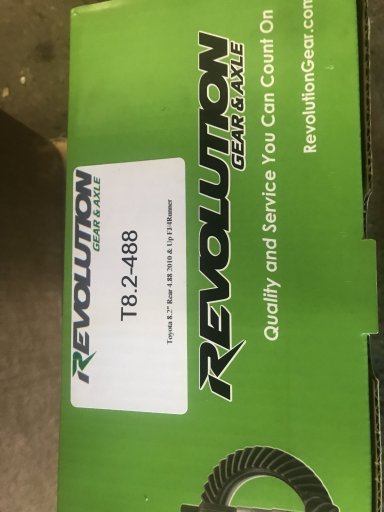

Well finally, my baby is double locked, front and rear ARB air locker with steel braided air lines and a 4:88 re-gear. Finished her today, Dan at Taylor Axelworks installed the lockers and did the re-gear. Dan is an awesome person and does great work, so if you need any work done head up to Diamond Springs and see Dan.
fullsizeoutput_b03.jpegfullsizeoutput_b04.jpegfullsizeoutput_b05.jpegIMG_2588.JPGIMG_2589.JPGIMG_2590.JPGIMG_2591.JPGIMG_2596.JPGfullsizeoutput_b06.jpegIMG_2598.JPGIMG_2599.JPGfullsizeoutput_b07.jpegfullsizeoutput_b08.jpegIMG_2623.JPGIMG_2624.JPGb36VhH5zThaa4NTAdZ3ANg.jpgkVQz7DaBTS6HiPHOsVKbVQ.jpgfullsizeoutput_b0a.jpegfullsizeoutput_b0b.jpegX2l%cEQ0T3q84ht8XdA8vw.jpgX2l%cEQ0T3q84ht8XdA8vw.jpgfullsizeoutput_b0d.jpeg

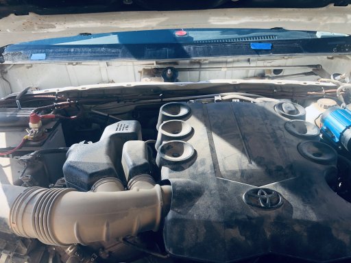

Well this happened. @Firemom and I installed our dual battery system and Redarc BCDC 1225D DCDC to DC charger yesterday. Fairly easy install, had to make our own mount for the Redarc charger. Used a C4 Fabrication dual battery tray and got the battery at Sears, but everything else was picked up on Amazon. Built the entire set-up for under $900.00

In your installation did both products(charger and 2nd battery) qualified for the hot under the hood area installation?
Also is your 2nd battery a deep cycle battery?
I need to install a deep cycle battery but was not sure which type will survive the heat better (in Texas)
I am in the process of converting my lx470 to a camper/overland rig and planning to do similar installation for battery.

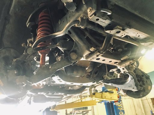

Next week, FJ Cruiser Transfer case swap..... Stay tuned..View attachment 121116
I cant imagine the cost you have incurred by making this change over but I know it was an arm and a leg by my standards. May I ask, why are you changing out the transfer case. My big question is did your rig ever fail go take you somewhere you wanted to go but couldn't because of the gearing or the lockers ?
Yes the battery is an deep cycle AGM battery. They are both also rated for the heat. It gets pretty hot in the summer where we live in NORCAL. In the summer it can get up 112 and I haven't had any problems. I bought a little 55 amp hour Die Hard AGM battery but will be changing it out for a better battery in the future. I can't complain though the battery only cost $160.00 at Sears.
Sorry about the late response,,, No it went everywhere I asked it to, but the electronic actuator on the 4runner case died and to replace that would have cost between $700 and $1,500 to replace and plus my time to do it and then I would have to worry about the possibility of it happening again in the future.
I did the swap for right at $500.00 (parts cost) and did the work myself... So it wasn't too bad.
