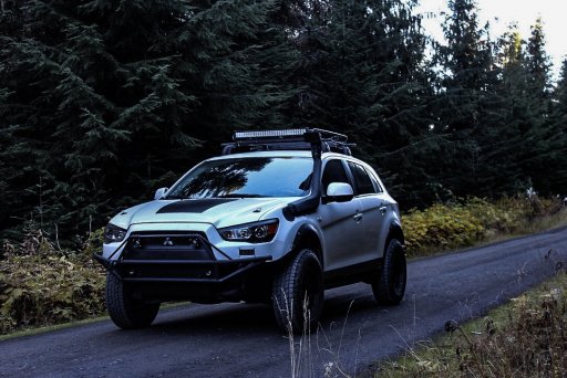

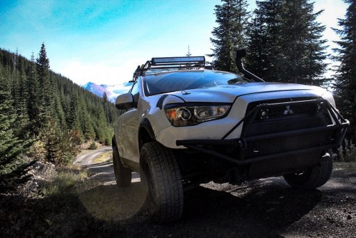

Two questions:
What offset do those American Racing wheels have?
Would the 235/15 tires have required fender cutting if you had installed the lift first? (Basically: with the lift, would those tires have cleared the uncut fenders)

Hey James, here is a link to AR’s website. I have the 15x7’s with a 4” BS.
https://www.americanracing.com/wheel/8848/ar767
As for the tires, no the fender flares were not required nor was the lift for the tires. I did have some rubbing on the inner part of the wheel wells though and on the unibody frame. I had 1” wheels spacer but removed those as it gave me WAY to much tire poke and extensive rubbing with this wheel/tire setup.

So... to clarify:
235/15 tires can fit (without spacers) with NO cutting, but may rub the frame and/or fenderwells?
James
Yes. I wanted more side-wall meat so went with a 75 side profile. You also should be more then fine with a 235/70-15. There’s a few other outlander sport owners who have run 235/70-16’s I believe. This is for outlander sports, I cannot speak for 235’s on your rig.
