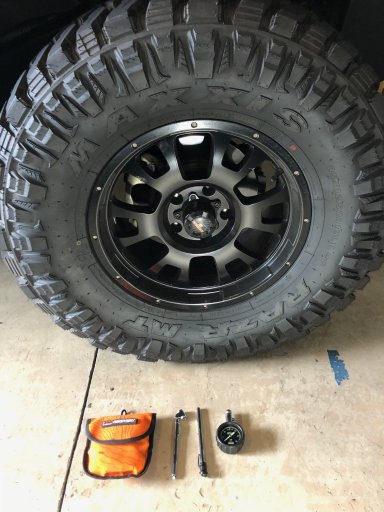

I just got some nice new tires and I wanted to make sure I am running them at the proper PSI. This is not my first rodeo with a Jeep JK or JKU or Land Cruiser with oversized tires and an E load rating. But come on, can I get an accurate reading or at least close to accurate. When we air down in the trails it would be nice to know that I am at 30 PSI and I aired down to 18 PSI. NOT, I started at the number 24 on this gauge and now I am at 12. It would be nice for it to be accurate. Just a bit of a gripe after I bought 2 expensive named brand gauges and they are so far off the others that I have no idea of what the "true" reading is. I guess doing it the old fashion way of "It looks about right" maybe my best bet.

I would immediately disregard the 2 rod style gauges. There's a reason they're always cheap. I've never seen an accurate one in my life. The ARB one is my go to, but I'm looking at getting a digital version potentially.
If you are really concerned about the tyres pick one gauge and stick with it. Then through observation (tyre wear, tyre temp.) and ride quality adjust to a pressure you're happy with (for example 31 on the ARB gauge). Then just keep using the ARB gauge and if its decent quality it'll be consistent if not 100% accurate. Consistency is more important than accuracy.

The SLIME Stick gauge was perfectly accurate. The rest were off. I went to a local tire dealer who just had his equipment calibrated. The ARB was in fact 6 pounds off. That was surprising to me. He encouraged me to get a quality gauge and not rely on the stick gauge too long. They tent to have a short lifespan.

I borrowed a calibrated gauge from a friend who's an aviation mechanic. I sent back 4 arb guages before giving up on getting an accurate one. The best I've found testing side by side are some of the large glow in the dark face race gauges like the circle track guy's around here use.
That said the number isn't nearly as critical so much as consistent proper inflation. If you've set your pressure initially with the chalk method(or with an IR temp gauge if you're so equipped) so long as you can reset/ check using that same gauge you set them with it will work fine.

I have two Accu-Gauges and they are within a psi of eachother.
Last year I purchased a JACO, but returned it because it was several psi off of my other gauges.

That ARB one should be returned/exchanged with no trouble. Explain to them that it is off, and why it is off. You should have no problems. I believe i read about another, who had the same issue with their ARB deflator gauge,
and the customer service took care of it. If they do send a replacement, ask that it is checked and or calibrated first. Jeff in their customer service department has done me right, as another OB member who had an issue with a ARB product fail. Good luck.

I've spent 40+ years in the tire business. Finding an accurate gauge is difficult at best. Stick gauges are the worst and digital are best but even those are hit or miss. The TPMS systems on newer vehicles are very accurate. Many vehicles have a readout on the info display showing the pressures on all 4 tires. If you have a vehicle with this feature, check your gauge against what the vehicle readout says.
